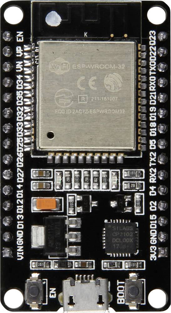

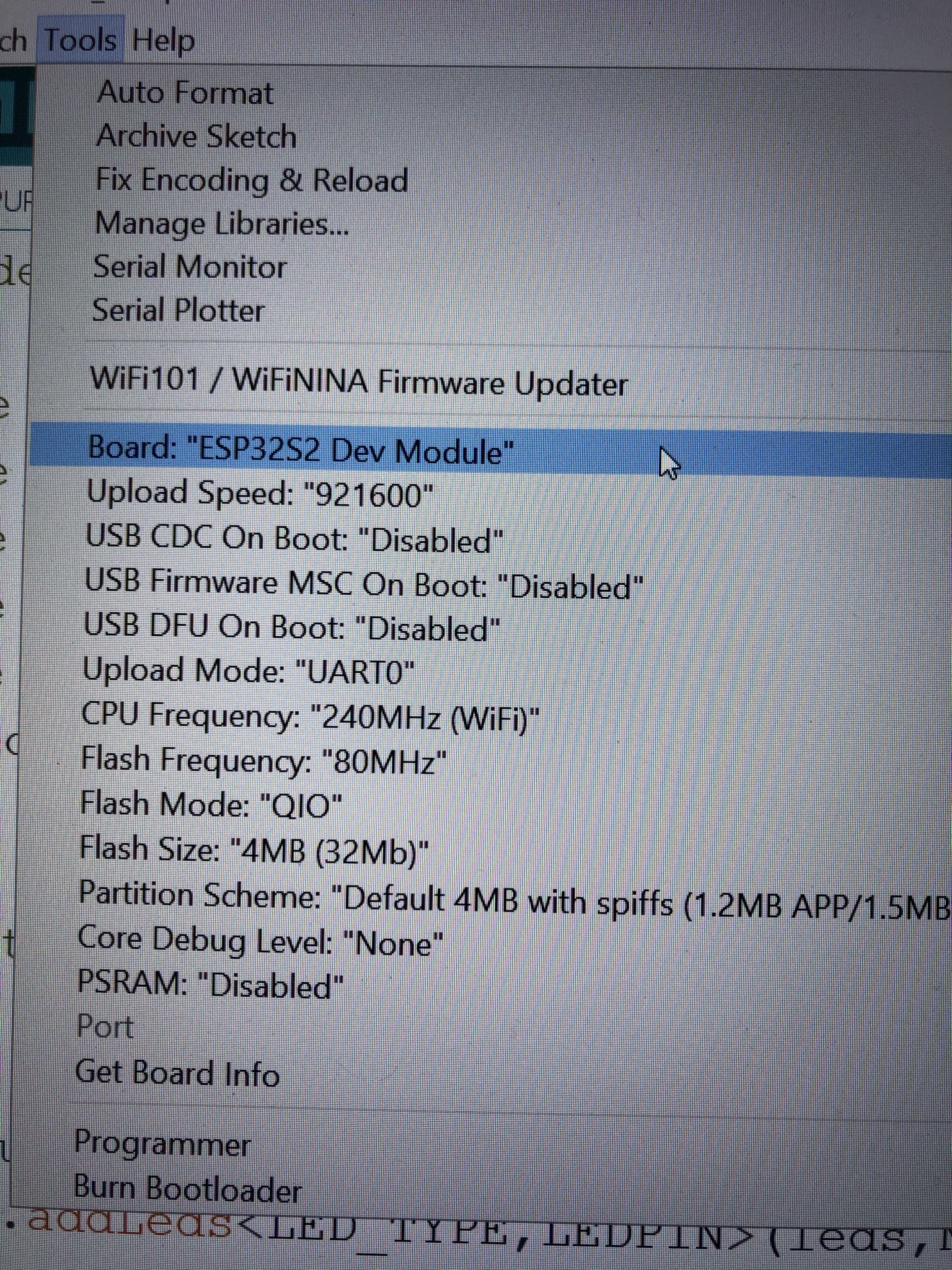

johnfrancisbarjols
- Posts: 6
- Joined: Thu Oct 21, 2021 7:52 am
Re: ESP32-S2 with Arduino IDE
I can't get a port conection in IDE, stays grayed out. Using Windows 10.
I have followed the unstructions , installed all the drivers . All the ESP boards are listed including ESP32s.
The description of the board I bought on Amazone is
"SeeKool ESP-32S ESP32 Development Board WiFi + Bluetooth 2-in-1
Dual Core 2.4 GHz Antenna Module with RF Antenna Amp AP STA
Filter Arduino IDE, Ultra-Low Power" jpeg imaged attached.
This is my third of playing with this with no luck for a COM3 conection
Under Boards in the IDE there is a list of things enabled and disabled. Is there
something that has to be done there? JPEG attached.
Thanks for any help
Thanks for any help
