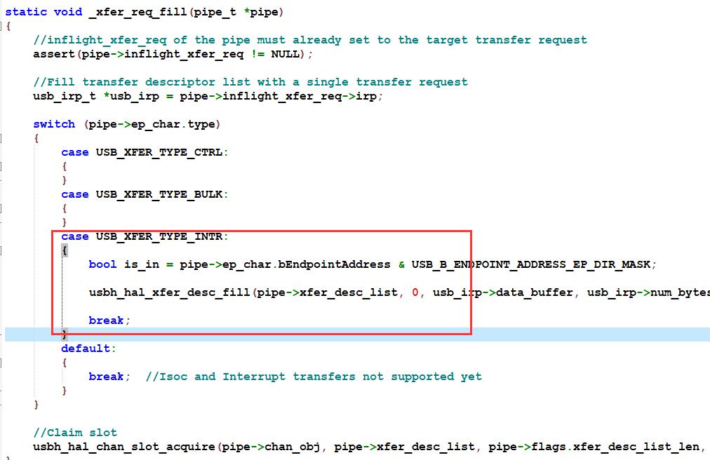

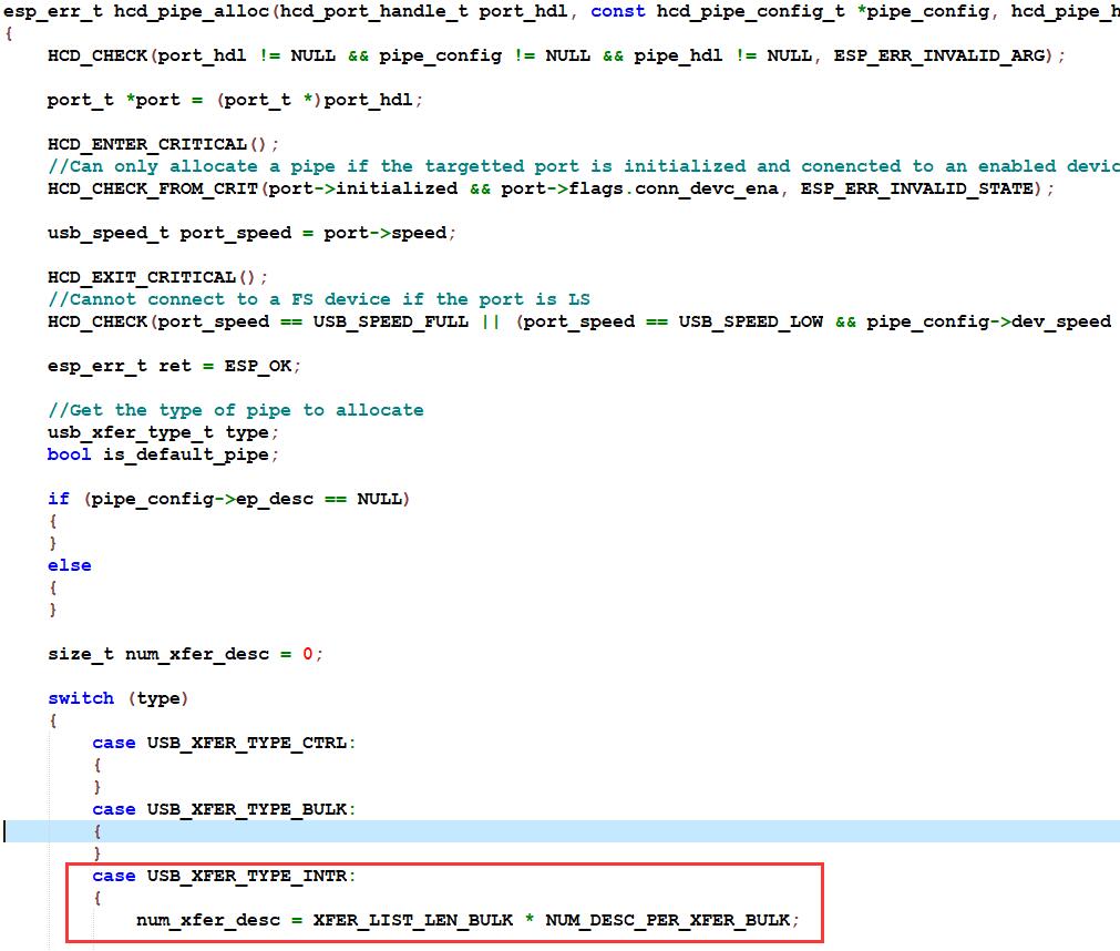

你好,请问,怎么才能启动中断传输呢?
我现在启动中断传输后,chan不产生中断。
chegewara
Posts: 2505
Re: USB host example
Postby chegewara » Sun Apr 25, 2021 4:17 pm
Sorry, but INT endpoints are not supported yet. Ive been playing a bit with code, but i failed, and i thought i removed all changes i made.
You can replace content of that file with original content from espressif:
https://github.com/espressif/esp-idf/bl ... 1621-L1665

你好,是否有ESP32-S2 USB HOST 周期性请求队列的操作说明或相关文档呢?
目前的参考手册没有这方面的说明。
