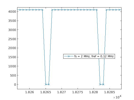

Which IDF are you using? Before pointing to 2Msps, did you try with slower sampling rate?
Could you show me some of your code?

Hi Gianluca,
thanks for your reply,
I tried several sampling rates from 3 kHz to 100 kHz but it didn't work for any of them.
I am using the esp-idf version 4.1.
Here is the code that I used. I reused quite a lot of Your code.

hello klaetze,
Giving a quick view of your code I noticed some point.
In your configuration, you set ".bits_per_sample = I2S_BITS_PER_SAMPLE_16BIT,", so, when you make a calloc you will need:
uint16_t* adc_data_buf = (uint16_t*) calloc(NUM_SAMPLES, sizeof(uint16_t));
And so, in your read:
ret = i2s_read(I2S_UNIT, (char*)adc_data_buf, NUM_SAMPLES*2, &bytes_read, portMAX_DELAY);
because you are casting adc_data_buf as a (char*)

Hi Gianluca,
You are right that doesn't make sense in my code. I changed it according to your suggestions.
The problem unfortunately remains the same.

Hello klaetze,
try to put ".use_apll = false," and also, which kind of values are you supposed to read?
To do some test, you can try to set up a DAC output and bring it (by a wire for example) to che ADC pin and try to read it in order to have a specific value.

Postby klaetze » Thu Apr 22, 2021 1:37 pm
I have already tried both .apll=true, and apll=false, without any difference.
As input I use a cosine wave with a frequency of about 400Hz for testing purposes. I have also used constant values of 2.0V, but the adc display remains zero. :|

Postby klaetze » Thu Apr 22, 2021 6:42 pm
With the following code (quite messy) I am able to get realistic adc readings up to a frequency of 10 ksps however as soon as i increase the sampling rate over 10 ksps the adc-readings are all zeros again.

klaetze
Posts: 13
Joined: Tue Dec 29, 2020 6:45 pm
Re: Uncorrect ADC iniziatization with I2S
Postby klaetze » Mon Apr 26, 2021 7:51 pm
Hi Gianluca,
i measured the Sampling frequency with an oscilloscope and its indeed 2 Msps.
I also made a measurement with a pwm signal of 120 kHz and a duty cycle of 90%. As you can see on the picture it is pretty much 2 Msps.
