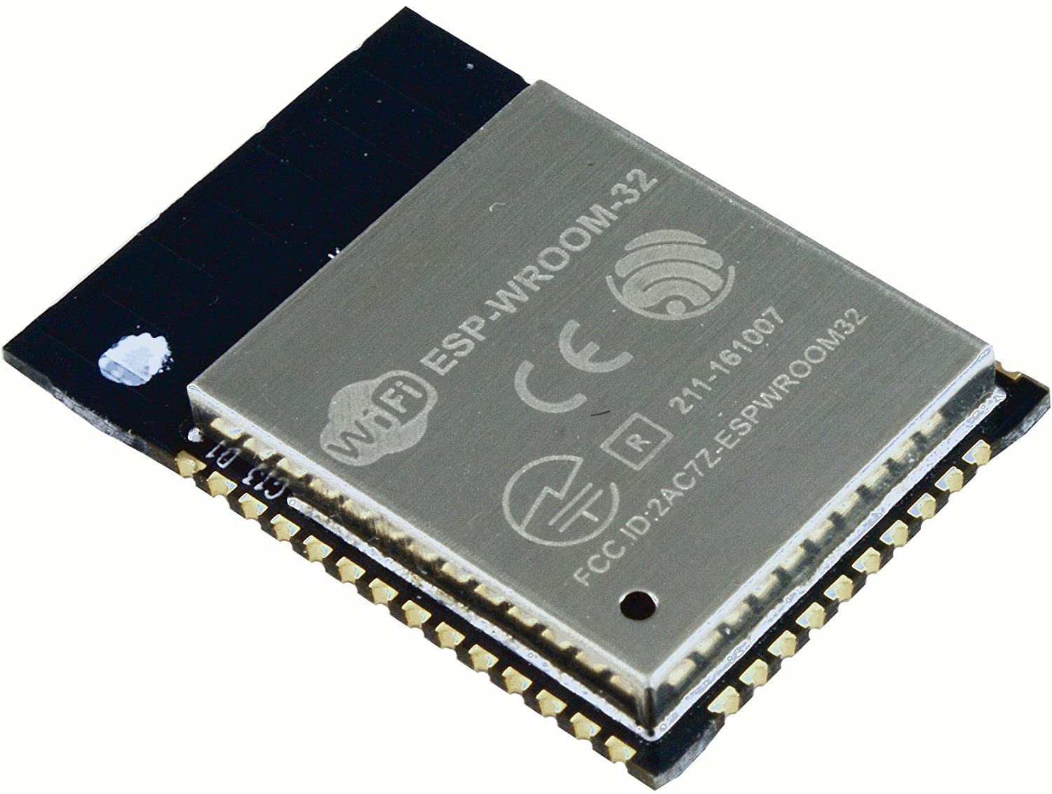

Its the oldest I own, and it has this characteristic stain on the left side of the pcb antenna like this one:
