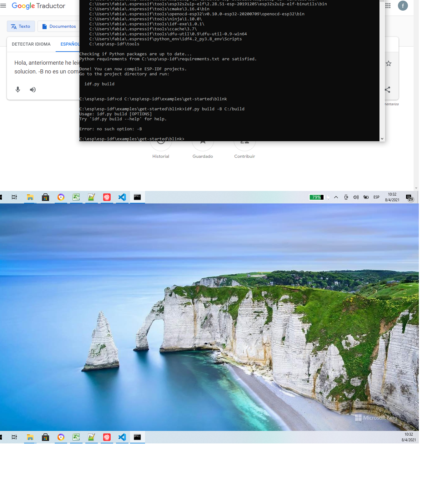

Hello, I have previously read the documentation. But I did not find the solution. -B is not a command that detects me idf.py
C:\esp\esp-idf\examples\get-started\blink>idf.py build -B C:/build
Usage: idf.py build [OPTIONS]
Try 'idf.py build --help' for help.
Error: no such option: -B

I found the following works for me (which is not in the order shown in documentation):
idf.py -B f:\temp build
Works!! Thank you so much.
