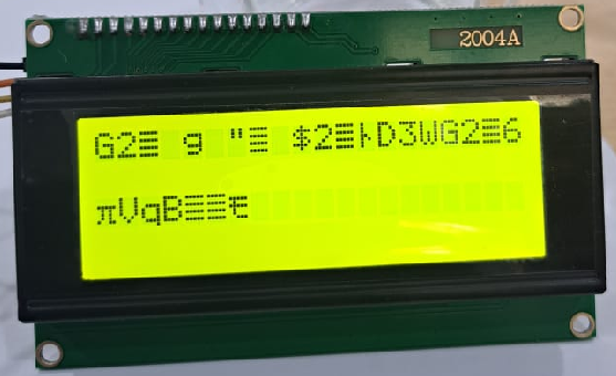

Hi, In my ESP32 IDF LCD display working not proper. In my reference library url is https://github.com/maxsydney/ESP32-HD44780 it return to display is not properly, why it happened? anyone please clear my problem. I share it my display.
- Screenshot from 2024-02-06 17-37-09.png (169.64 KiB) Viewed 7172 times

Great component. Thanks for sharing your code. I am with the same problem here, the characters are truncated on the screen. I had to make some adapts to make the component work with the espressif idf 5.x.x.
Trying to figure out what's going on. Testing with esp32c3 supermini.

Hi tamiloli,Hi, In my ESP32 IDF LCD display working not proper. In my reference library url is https://github.com/maxsydney/ESP32-HD44780 it return to display is not properly, why it happened? anyone please clear my problem. I share it my display.
I had a similar issue with my display when using that library. In my case, the problem was related to the delays in "HD44780.c". I solved it by simply doubling the delay values. For example:
// Original:
vTaskDelay(100 / portTICK_PERIOD_MS);
// Modified:
vTaskDelay(200 / portTICK_PERIOD_MS);
I hope this helps with your setup !
