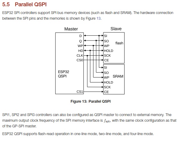

Are you sharing the SPI channel for the internal FLASH ESP32-D2WD with the ESP-PSRAM?
For connecting an external ESP-PSRAM with ESP32-D2WD using the same SPI channel, are you connecting the PSRAM as follows;
GPIO8(psram_d) ,GPIO17(psram_q), GPIO7(psram_wp), GPIO11(psram_hd) and then use GPIO7(psram_cs) and GPIO8(psram_clk) ?

Does this mean GPIO9 and GPIO10 can be used instead of GPIO16 and GPIO17? Also, are the pins physically wired or can the GPIO matrix be used to switch out the pin functions? Thanks!

No, sorry. The flash and psram have slightly different timing requirements, and the intrinsics of the cache mechanism makes it impossible to cater to both using one clock line. I was surprised by that myself as well and suggested a few workarounds to the digital team, but seems they already thought of all of them and the only way to make it work is by using a separate clock line.

then sry - this info in the tech referenz manual is then wrong and a bug - please add me to the bug bounty for it :|
Side 79
ivan tweets last hours the same and i think then the referenze manual need an update asap and very fast.
now the pSRAM puzzle becomes more face
D0WD:
we need 1.8V, S3:S0 share pins, CLK and CS is difference to the Flash, pSRAM use IO16 for CS and IO17 for CLK

Hello I would like to ask a hypothetical question:
If I make the following assumptions:
1.) I use the ESP32-D0WDQ6 or ESP32-D0WD or the ESP32-S0WD chip
2.) I would have a pSRAM chip with a nominal supply voltage of 3.3V at my disposal...
3.) I connect the external SPI flash and the pSRAM chip to the "VDD_SDIO" output pin of the internal LDO of the ESP32 only (with reasonable supply decoupling, VDD_SDIO not connected to VDD3P3_RTC)
4.) I configure the internal LDO that it has the same output voltage as VDD3P3_RTC (as it is mentioned in the data sheet V1.4, page 9).
Would this not be the solution to the pin strapping/ eFuse Deep-Sleep problems?- In the datasheet V1.4, page 9 it is explicitly mentioned that the LDO can be powered off/ the output can be disabled even if the LDO is bypassed/ outputs the same voltage as VDD3P3_RTC:
"The internal LDO can be configured as 1.8V, or the same voltage as VDD3P3_RTC. It can be powered off via software to minimize the current of flash/ SRAM during the Deep-sleep mode."
Is my understanding of the datasheet correct?
If yes: The next question for me is: Why does Espressif not use a "wide VDD" SPI flash in the ESP32-D2WD?- This way round everything could work for the ESP32-D2WD, too (the device could be used with 1.8V or 3.3V VDD_SDIO)?
Thank you for an answer.

If you use a hypothetical 3.3V pSRAM and a 3.3V flash, both powered from VDD_SDIO, and you configure the internal LDO by means of an Efuse or a strapping pin, then there should be no issues with deep sleep. That being said, i do not understand what kind of problems you mean by "eFuse Deep-Sleep problems".
