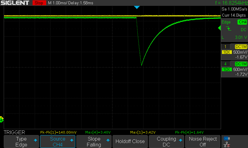

Good morning,
We are working on a project involving a GPRS/GPS module (BK-868 : http://www.and-global.com/index.php/pro ... akout.html) and a ESP32-WROOM.
The GPRS/GPS module can have huge current spikes but the power supply we designed is ready for it and we can see no voltage drop on the 3V3 power supply rail.
The following scope capture shows the 3V3 rail and the voltage on EN line : (Green = GPIO34 / Yellow = 3V3)
The EN pin is connected to the 3V3 rail as shown in the Espressif's documentation for the ESP32-WROOM (with a 10k resistor and a 0.1µF ceramic capacitor to ground).
Those voltage drops can cause the ESP32 to reboot and cause our whole system to crash.

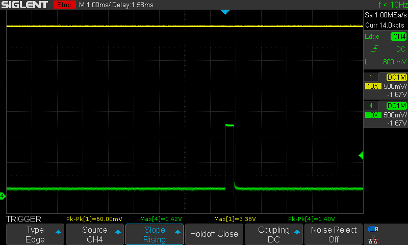

We spotted a similar phenomenon on GPIO34. When we observe the voltage drop across pin EN, we can see a sharp edge on GPIO34. This phenomenon stays without explanation : (Green = GPIO34 / Yellow = 3V3)
How can we explain that the EN line drops so much while the 3V3 rail stays constant ?
The power comes from two LiPo batteries in series, then go into a LM2596 buck converter, then in a 3V3 linear regulator to the ESP32.
Thanks a lot for your ideas and help
Have a great day,
Paul
This statement is confusing. Is the scope capture for the green line showing the EN line, or GPIO34 ?

mbratch
Posts: 317
Joined: Fri Jun 11, 2021 1:51 pm
Re: Voltage drop on EN pin causing reboots
Postby mbratch » Sun Jul 18, 2021 11:06 am
Can you show an image of that portion of the schematic where EN is linked to 3V3? I know you described it, but seeing all the related connections would be helpful. Also show the locations where your scope probes are being placed. It's not making sense to me that 3V3 is tied to EN, but only one of them dips sharply.
