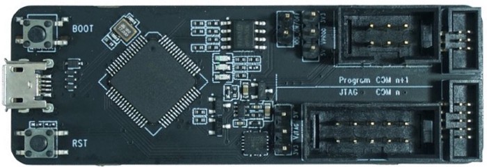

I'm trying to use the same JTAG adapter (see picture in the attachment), which I used with ESP32 without any problems (connected only via the USB connector from the JTAG adapter), with the ESP32-S2 (ESP32-S2-Saola-1R board) and it doesn't work at all.
I connected them as following:
Saola Board		JTAG Adapter
PU			EN
IO0			IO0
TxD			TxD
RxD			RxD
IO40			TDO
IO41			TDI
IO39			TCK
IO42			TMS
Connected in this way, it worked straight away between the ESP32 and the JTAG adapter.
I've tried step by step to connect them. As first only the serial lines and so on...
But I can't even get serial communication through. To make sure that the Saola board gets enough power, I have already connected a power supply unit (without data lines) to the USB port of the Saola board and removed the power supply jumpers on the JTAG adapter, but it doesn't work either.
Are the two boards incompatible with each other?
Is there anything else I need to do to make it work?
Has anyone had any experience with the Saola board and the JTAG adapter?
Can someone help me?
Thanks in advance,
Michael

A small addition/correction to my problem description:
When I use PuTTY on the "/dev/ttyUSB1" and press the reset button on the JTAG adapter, I'll get the expected output:

I don't get any connection at all when I run the command 'idf.py -p /dev/ttyUSB1 flash':
$ idf.py -p /dev/ttyUSB1 flash
Executing action: flash
Running ninja in directory /home/mick/Projects/ESP32-S2/sdcard/build
Executing "ninja flash"...
[1/4] Performing build step for 'bootloader'
ninja: no work to do.
[1/2] cd /opt/ESP32/v4.3/esp-idf/components/esptool_py && /usr/b...t/ESP32/v4.3/esp-idf/components/esptool_py/run_serial_tool.cmake
esptool.py esp32s2 -p /dev/ttyUSB1 -b 460800 --before=default_reset --after=hard_reset write_flash --flash_mode dio --flash_freq 80m --flash_size 4MB 0x8000 partition_table/partition-table.bin 0xd000 ota_data_initial.bin 0x1000 bootloader/bootloader.bin 0x10000 sdcard.bin
esptool.py v3.1-dev
Serial port /dev/ttyUSB1
A fatal error occurred: Failed to connect to ESP32-S2: Timed out waiting for packet header
CMake Error at run_serial_tool.cmake:50 (message):
  /opt/ESP32/v4.3/python_env/idf4.3_py3.8_env/bin/python
  /opt/ESP32/v4.3/esp-idf/components/esptool_py/esptool/esptool.py --chip
  esp32s2 failed
FAILED: CMakeFiles/flash
cd /opt/ESP32/v4.3/esp-idf/components/esptool_py && /usr/bin/cmake -D IDF_PATH="/opt/ESP32/v4.3/esp-idf" -D SERIAL_TOOL="/opt/ESP32/v4.3/python_env/idf4.3_py3.8_env/bin/python /opt/ESP32/v4.3/esp-idf/components/esptool_py/esptool/esptool.py --chip esp32s2" -D SERIAL_TOOL_ARGS="--before=default_reset --after=hard_reset write_flash @flash_args" -D WORKING_DIRECTORY="/home/mick/Projects/ESP32-S2/sdcard/build" -P /opt/ESP32/v4.3/esp-idf/components/esptool_py/run_serial_tool.cmake
ninja failed with exit code 1
It also does not work when I start flashing with additional agrument "-b 115200".
Sometimes the connection with 'idf.py -p /dev/ttyUSB1 monitor' doesn't work also and sometimes it works.
I don't think the cause is possibly loose wiring.
