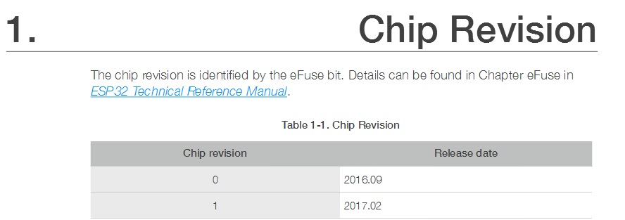

if we talk from the revision of esp32 and just in time the actually revision,
this is named with silicon revision 0
the new revision of esp32 has the revision 1 and release date 2017.02

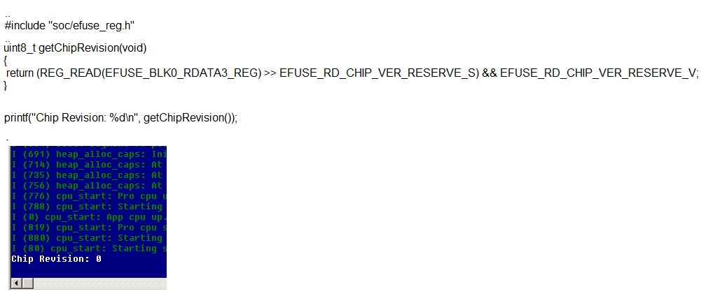

we canread this by software and efuses best wishes

rudi , is that information from EFUSES fully trustable? The piece I have was supposed to be silicon version 1 and I'm reading 0.

ikerbelloso wrote:rudi , is that information from EFUSES fully trustable? The piece I have was supposed to be silicon version 1 and I'm reading 0.
if you not get this "sample" piece explicitly from espressif, then i think you only have Rev 0
cause the silicon Rev 1 is "just in time to go on" and example to built in in new ESP32 Modules "Wrover"...

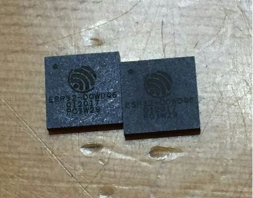

the ESP32-D0WDQ6 sample came from distribution as silicon version 1 and I've replaced into a ESP-WROOM-32 module.
the piece marking says 012017 , PC3W29. Apparently the manufacturing week doesn't ensure being V1 but, from ESP_igrr words, prior to that there were some pieces manufactured.

012017 is devinitiv Rev 0ikerbelloso wrote:hi rudi
rudi
edit:
btw: PC3W29 is the batch id of "silicon wafer"
