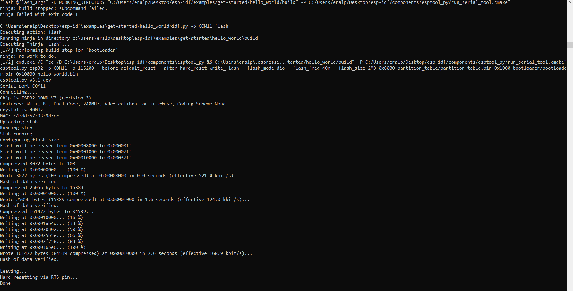

Solved Issue I am able to flash code as well as to detect flash.
The issue with soldering and now Solved.
Please find below attach Image of the flash code process.
Flash code done

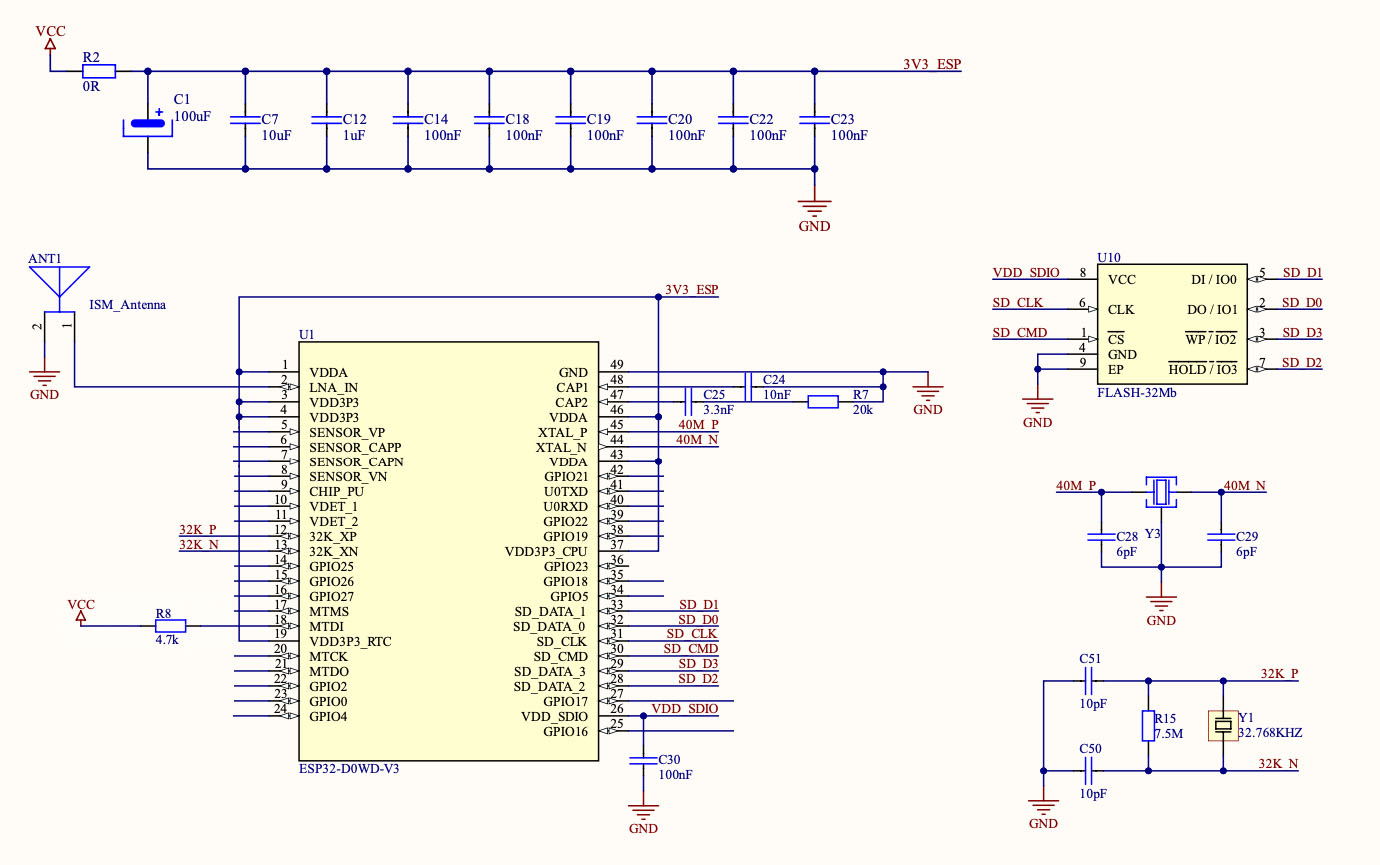

Can you please check my schematic and let me know if you see anything wrong with it?
Thanks!

Hm, I'm afraid I don't see anything obvious that is an issue... perhaps it helps to scope out the WP/HOLD pins of the flash, see if there's any activity at all on those?

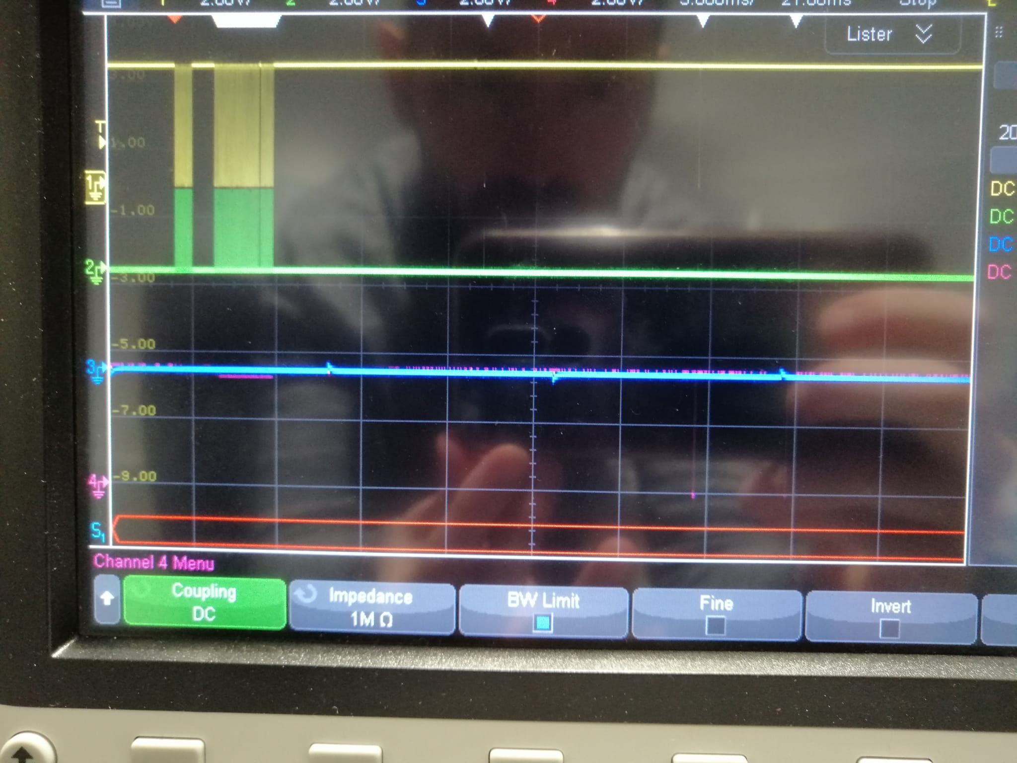

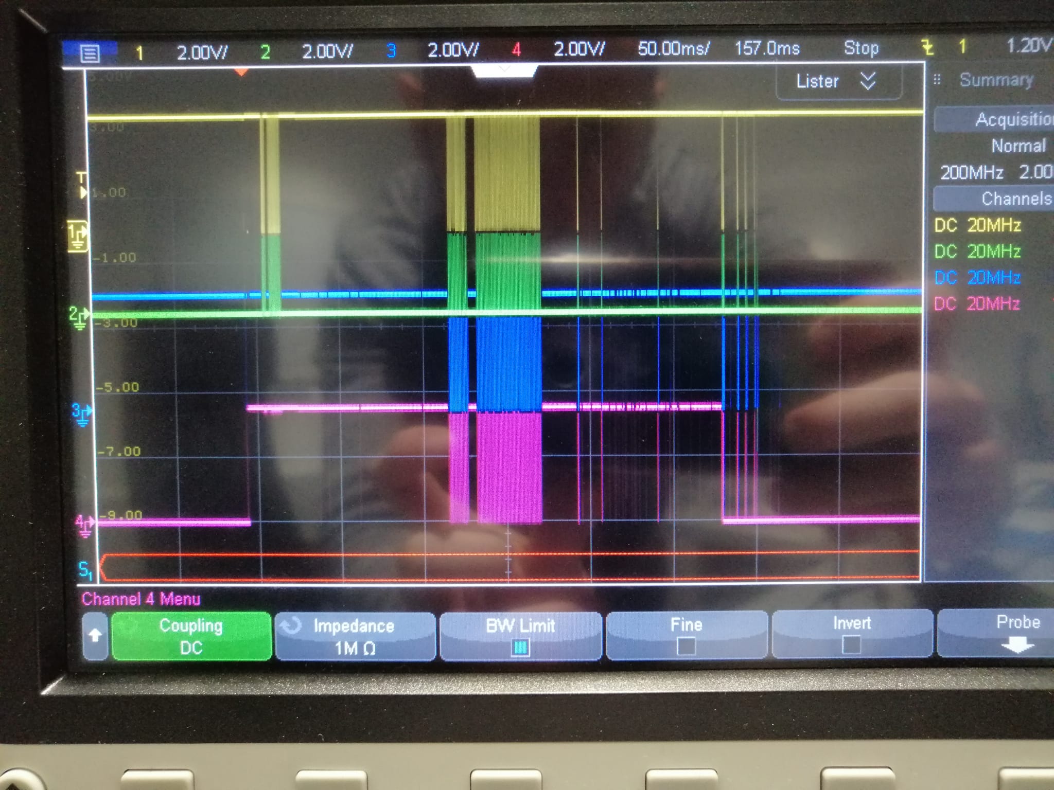

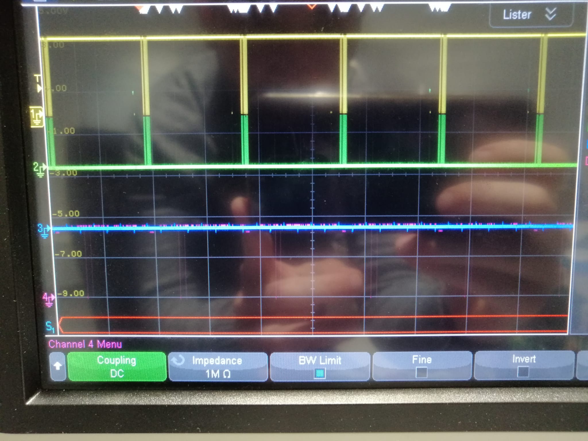

Scoping revealed there is no activity on WP line, it is not even High, and some on HOLD line (perhaps in wrong timing?). This should not be a soldering issue as the same signals are scoped directly on ESP pads. Also, solder joints inspected using microscope, look flawless.
Here are scopes of all data lines, ESP stuck in reset loop, and a zoomed section - sorry for glared pics:
WhatsApp Image 2022-01-24 at 5.49.19 PM.jpeg (292.33 KiB) Viewed 10338 times
WhatsApp Image 2022-01-24 at 5.50.40 PM.jpeg (252.05 KiB) Viewed 10338 times
For reference, here is the same scope from a Wroom using same FW.
WhatsApp Image 2022-01-24 at 5.48.58 PM.jpeg (328.23 KiB) Viewed 10338 times
Could this be a PCB design issue? The longest line is 17 mm (DI) so no worries about transmission lines, right? Also, two lines have a pair of vias (DI and WP), could this be the cause?
