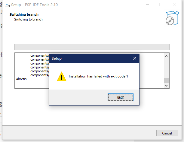

windows下idf-tools安装进行到 “Switching branch”时失败
Postby changyue » Mon Aug 30, 2021 6:11 am
安装时选择的版本为4.2
4.3版本可以正常安装
Setup Log 2021-08-30 #001.txt
(9.5 MiB) Downloaded 531 times

Re: windows下idf-tools安装进行到 “Switching branch”时失败
Postby Gargamel » Wed Sep 01, 2021 1:41 am
如果你能直接告知是离线安装,就更好了,从 log 中获取了此信息。
试了下确实有此问题,会反馈到内部。
Postby georgik » Wed Sep 01, 2021 10:48 am
Unfortunately we were not able to simulate the error.
Please, provide output of command:
git config --list --show-origin
The output could help us with diagnostics of the problem.
Postby georgik » Wed Sep 01, 2021 12:17 pm
Meanwhile we identified the problem.
If the git does not have autocrlf set to true in global config the installation fails.
To workaround the problem it's possible to enter command:
git config --global core.autocrlf true
After this correction the installation works without problem.
The new issue for this bug was created: https://github.com/espressif/idf-installer/issues/52
Postby georgik » Wed Sep 01, 2021 1:26 pm
We updated Offline installer, please test the following version:
https://github.com/espressif/idf-instal ... 11-beta-02
The installation of 4.2.2 should pass without problem.
