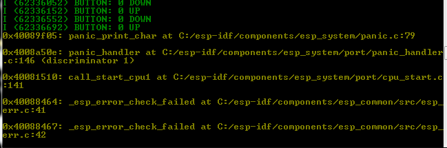

Hi
Please help me to seek where the problem is. It mostly happens when the logging is ON.
When I disconnect the uart the code works for months!
It happens when esp connects to wifi

I doubt it's a CPU starving issue... that would usually not lead to a reset in the panic printchar handler.
NIXIE_123, do you have logging from before the bit that you just posted? As in, more of the ESP32 log leading up to the yellow text?

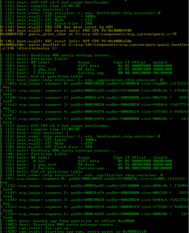

i have this:
It says MAC address was invalid. I was flashing .bin from 0 to 0x400000
Posts: 10596
Re: wdt reset at startup
Postby Sprite » Tue Sep 07, 2021 1:01 am
Hmm... that screendump doesn't really make much sense. The yellow lines are a decoded backtrace, the esp-idf monitor generates those when it finds things it thinks are valid memory addresses in the serial output. However, there's no serial output preceeding those lines that have any serial addresses in them. Also, the timestamp indicates the thing has been running for a long while (17 hours), while the stack trace points at startup code, something that should have run its course the first second.
