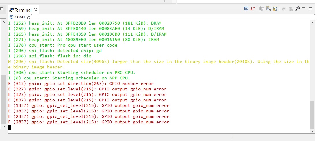

I have an issue using ESP32-PICO-V3 IO20 (pin 27). When executing, terminal says:
E (317) gpio: gpio_set_direction(263): GPIO number error
E (327) gpio: gpio_set_level(215): GPIO output gpio_num error
Here's the simplest blink example I'm using.
#include <stdio.h>
#include "freertos/task.h"
#include "driver/gpio.h"
#include "sdkconfig.h"
#define LED 	GPIO_NUM_20
#define RET	500
void app_main(void)
    gpio_pad_select_gpio(LED);
    gpio_set_direction(LED, GPIO_MODE_OUTPUT);
    while(1)
    	gpio_set_level(LED, 1);
        vTaskDelay(RET/portTICK_PERIOD_MS);
        gpio_set_level(LED, 0);
All other IO pins work fine.
Someone knows what's happening?

IO20 wasn't available on earlier packages, so it was considered invalid. Support was added in IDF very recently, so you'd have to pull in/copy the latest changes to use it:
https://github.com/espressif/esp-idf/co ... 21fd142b79

SOLVED. Thank you very much.
