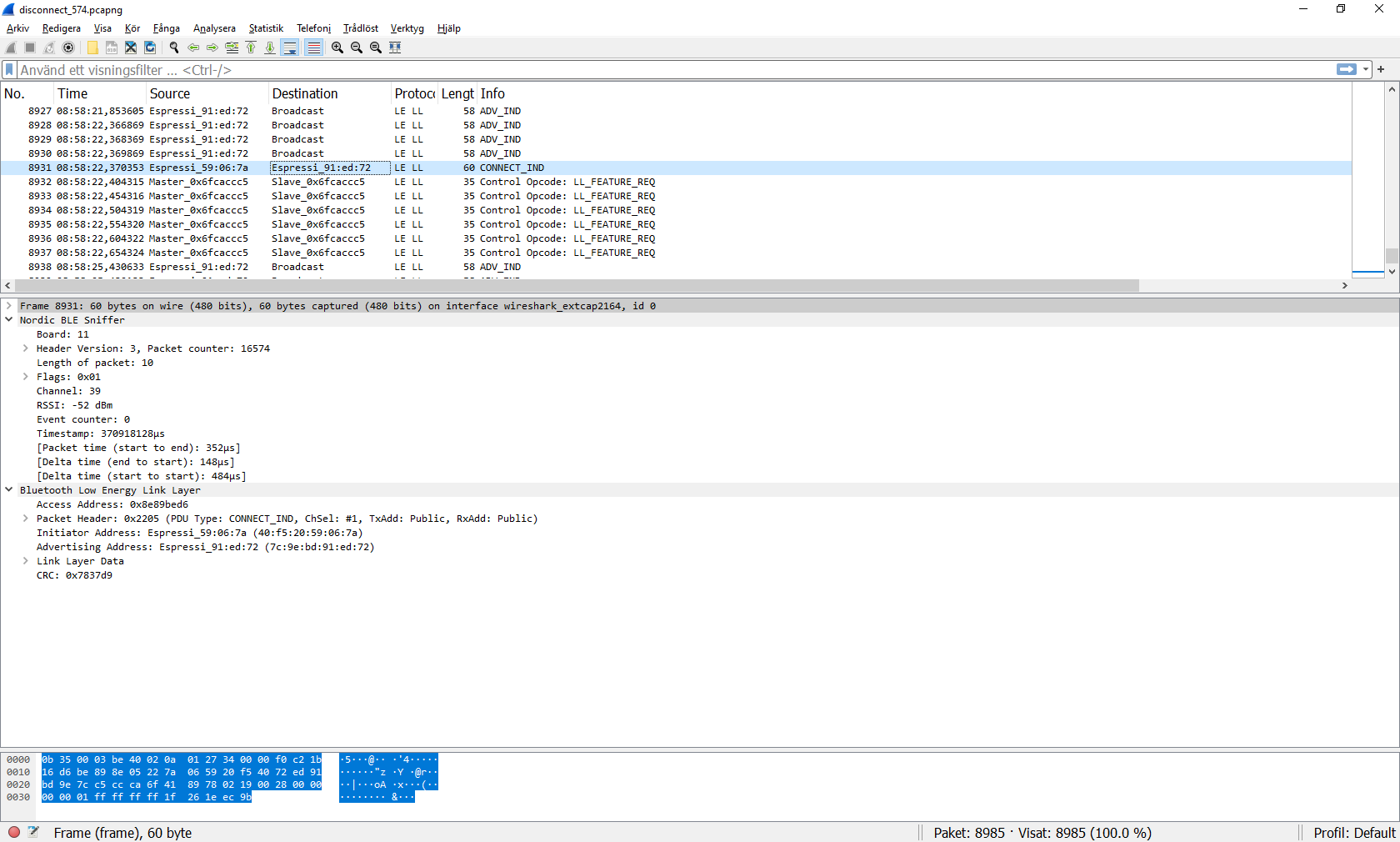

I added a Wireshark BLE sniffer log. The central can't connect to the ESP32 sometimes. ESP32 doesn't respond to the CONNECT_IND which is sent in packet 8931.
