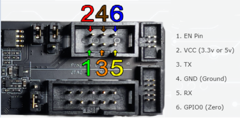

I was following a tutorial from a website where they teach how to connect the ESP-PROG board in its entirety including the debugger and programmer. I was able to connect the programmer by identifying the correct pins on both ESP-PROG and ESP32-CAM. However, I ran into a problem where I had to make the connection between the programmer and ESP-32CAM. In the tutorial, it is stated that the connection between these two boards must have an "EN" pin on the ESP32-CAM but, on the contrary, the board I have does not have such a pin.

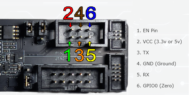

ESP-PROG
The pins on the ESP-PROG board

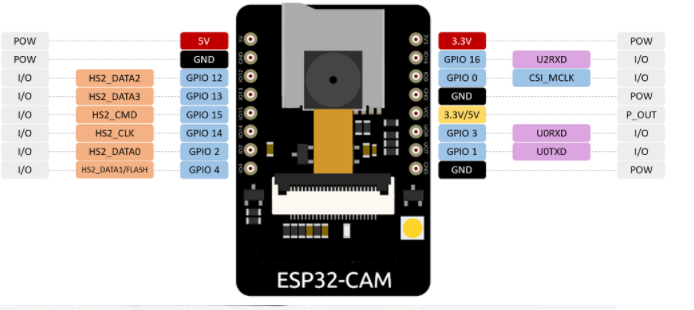

ESP32-CAM
The pins on the ESP32-CAM board
:? My queries are:
  • Are we sure that the ESP-PROG is compatible with ESP32-CAM in terms of "programming" apart from debugging?
  • If so, what should we do with the "EN" pin?
  • If not, should we connect both ESP-PROG and ESP32-CAM to a computer in order to program + debug?
Yes. ESP-PROG is compatible with all ESP SoC's series.
If you don't have the EN (Reset) pin available, you can tie the BOOT pin (GPIO0 on ESP32) and power on the board. You can use the jumper on the ESP-PROG but take care to use the 3V3 and not the 5V if you are powering the board by the 3V3.

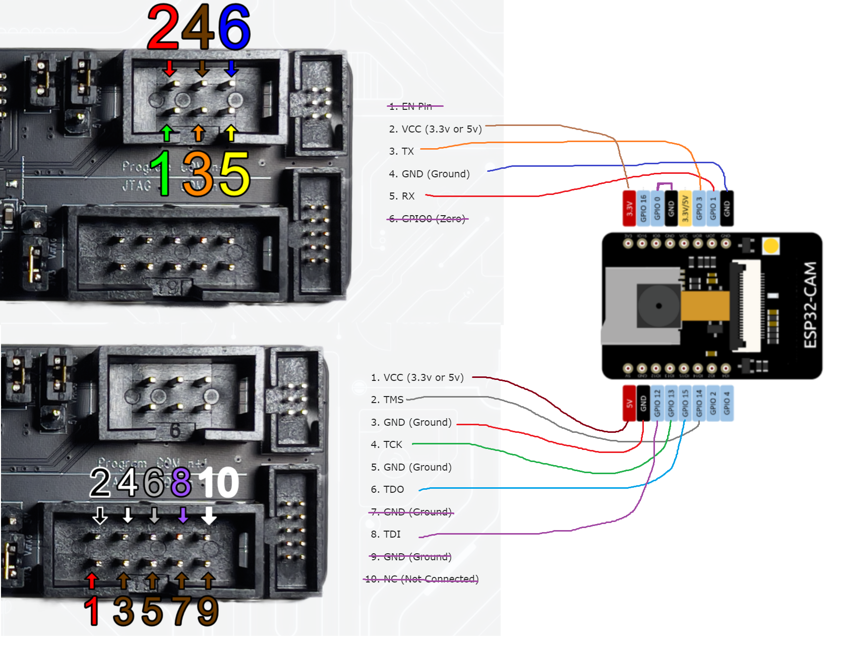

You can use the GPIO12 to 15 to connect the JTAG interface to the ESP-CAM. See this reference for more information about it.
To use the JTAG interface, you can use this document as reference: JTAG Debug

To flash the firmware using the ESP-PROG (assuming you will use the UART not JTAG), you need to get the ESP32 into "Download Mode".
You need to hold the GPIO0 in a low state (0) and then put EN to low and release it while still holding the GPIO0 low. After that, you can release GPIO0.
This can be done automatically by the ESP-PROG, but you need both pins available on your board. Since you don't have the EN pin, but you have the push button (marked as RST on ESP-CAM), the best way to get into download mode is by tieing the GPIO0 to ground (GND) using a ~10k resistor and then pressing the RST button or power cycle the board by removing and putting back the jumper on ESP-PROG.
To connect ESP-PROG to ESP-CAM:
ESP-CAM -> ESP-CAM
GPIO0 -> PULL DOWN to enter into download mode
GPIO1 -> RX
GPIO3 -> TX
GND -> GND
3.3V -> 3.3V (you can also power the ESP-CAM using the 5V pin)
Don't forget to release the GPIO0 after programming.

I apply the necessary connections like you said, there is an issue with the pin layout you suggested. I think the correct layout should be like this:
ESP-PROG -> ESP-CAM
GPIO0 -> PULL DOWN
GPIO1 -> TX
GPIO3 -> RX
GND-> GND
3v3 -> 3v3
GPIO3 and GPIO1 should change their places. Apart from this, I got an error message while flashing my empty program into ESP-PROG and the message is:

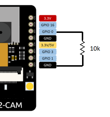

I connect GPIO0 to GND via a 10k resistor like this:
I tried holding RST down while flashing but it did not work.
This is my config file for vscode with platform io

I get this, I do not know why. I connected everything like you said.
This shows how my connections are
during
part, I press RST on ESP-CAM but nothing happens.
