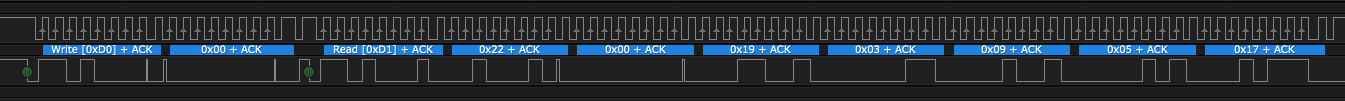

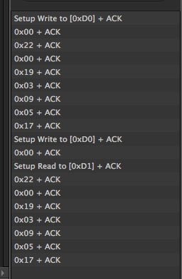

I keep getting the following error on the begin: ds1307: i2c_master_cmd_begin: 263
This is a timeout error. I plugged in my logic analyzer and I have its output below.
I believe this is for the write();
Screen Shot 2017-05-09 at 1.06.10 PM.png (12.28 KiB) Viewed 6950 times
I believe this is for the read();
Screen Shot 2017-05-09 at 1.06.23 PM.png (14.66 KiB) Viewed 6950 times
Output of both.
Screen Shot 2017-05-09 at 1.06.30 PM.png (35.02 KiB) Viewed 6950 times

You didn't mention which source line in the code was throwing the exception? Do you know that information?
Another guess ... looking at the read logic ... you send a "Write" to set the address in the device and then you read 7 bytes of data. However, look closely at the last byte of data you read ... you read it and then sent an "ACK". Now compare this with the following from the data sheet:
"The register pointer automatically increments after each byte are read. The DS1307 must receive a Not Acknowledge to end a read"
See also the following reported issue:
https://github.com/espressif/esp-idf/issues/377
It may be you should NOT be reading 7 bytes with an ack ... but instead read 6 bytes with an ack followed by 1 byte with a nack.
Neil

Mr, Kolban. Thanks! I read that line on the data sheet as well, and I wondered if that was my problem. I also read it on the DS1307 data sheet, and that's why I didn't explore it more. I'm not sure why it works on the DS1307 without the NAck bit sent on the last read, but I have it working now on the DS1339. Below I have the modified snippet
	uint8_t data[6];
	uint8_t data_end[1];
	ESP_ERROR_CHECK(i2c_master_read(cmd, data, 6, 0));
	ESP_ERROR_CHECK(i2c_master_read(cmd, data_end, 1, 1));
