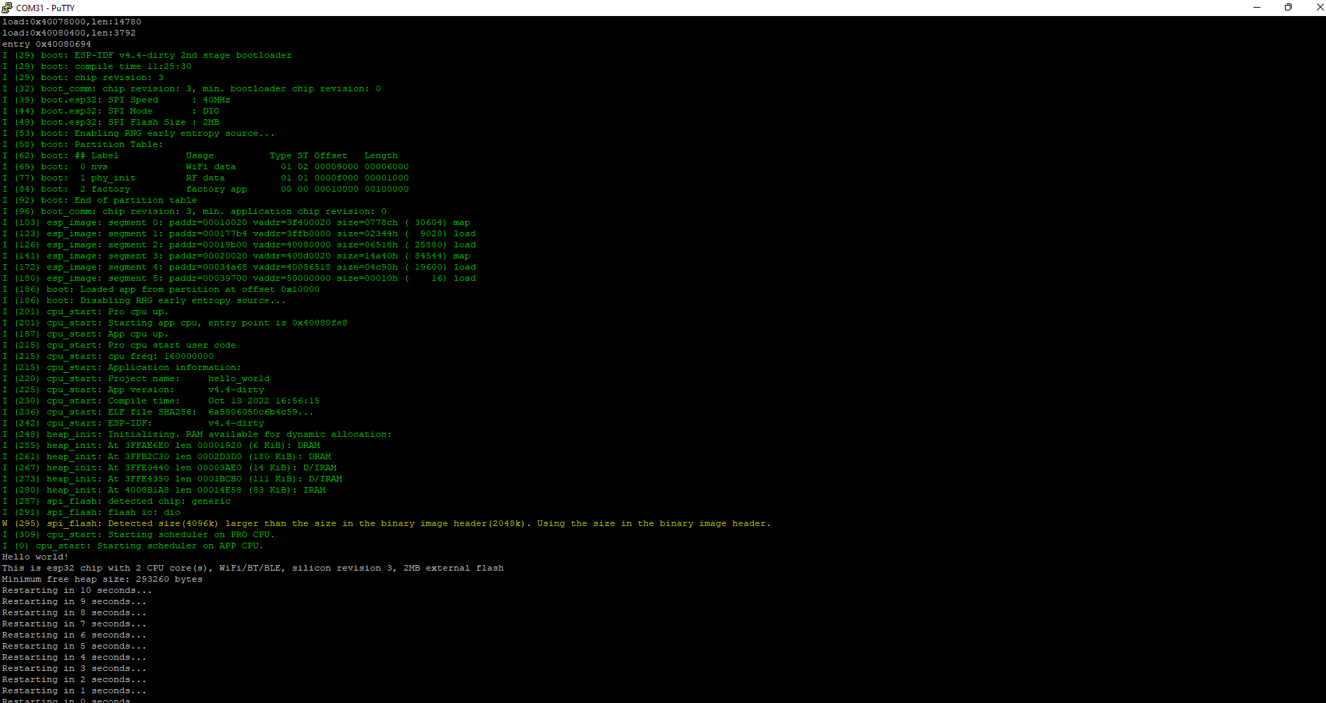

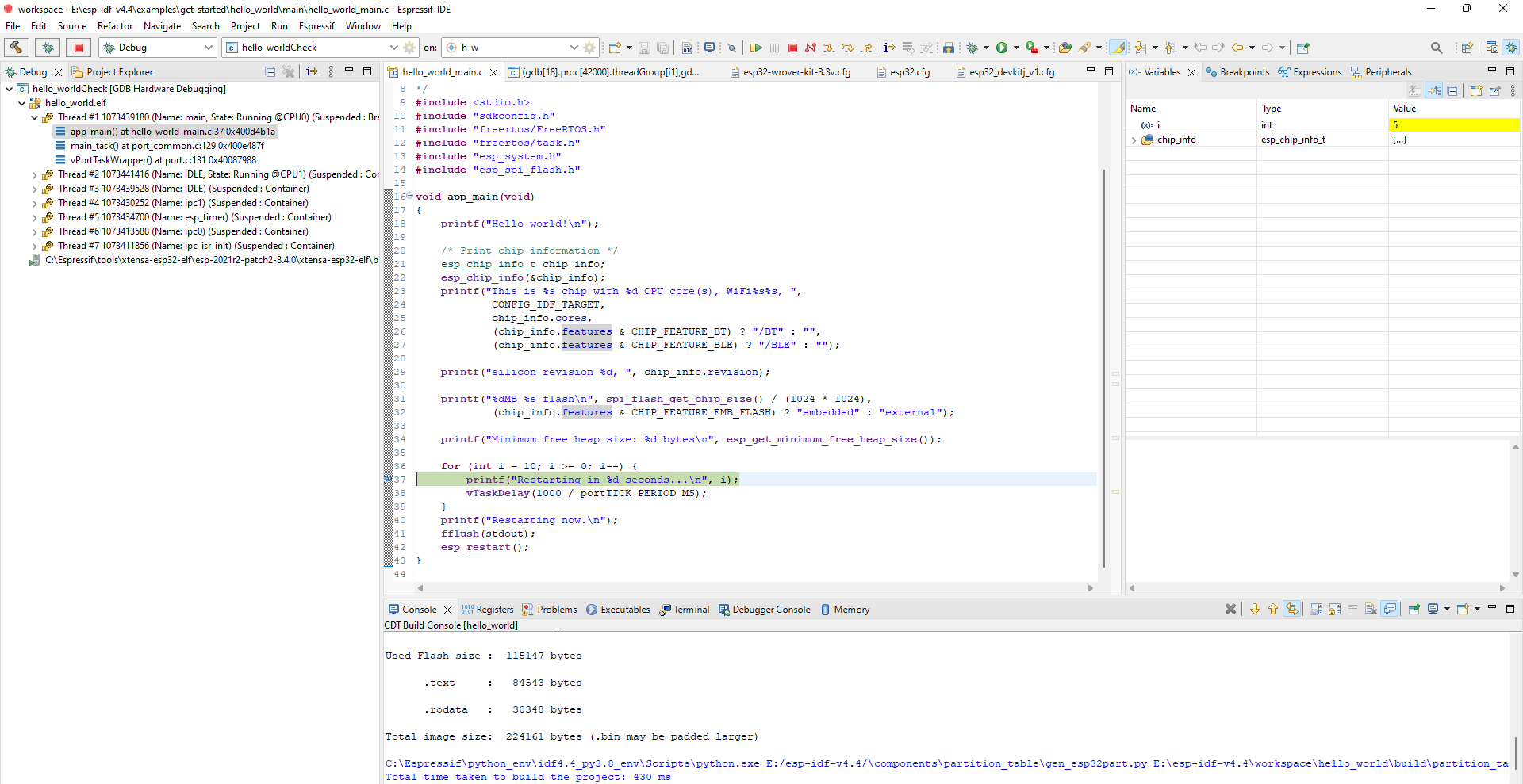

I too had this reply, or worse Lib usb not found. Then I tried again
https://docs.espressif.com/projects/esp ... -jtag.html .
First WROVER-KIT-V4.1 must be connected to Window PC through USB or any USB HUB: device manager will show 2 drivers, one for UART(A) an the other for JTAG (B). Now run Zadig and the driver in Device manager will remain only one: JTAG COM port. The board must always use this port or you have to run Zadig again.
Follow
https://docs.espressif.com/projects/esp ... un-openocd . I get more or less the first 10 lines of Immagine 2022-10-14 185751.png : no more errors.
Write this COM port in the Espress-IDE Target combobox.
Follow
https://docs.espressif.com/projects/esp ... er-eclipse . Launch the debugger from IDE. I get COM31-PuTTY14_10_202218_50_55.png and workspace - E__esp-idf-v4.4_examples_get-started_hello_world_main_hello_world_main.c - Espressif-IDE 14_10_2022 20_29_32.png. During my first clumsy attempts, only Teraterm was able to see the app output, but now also the less sophisticated PuTTY can.
