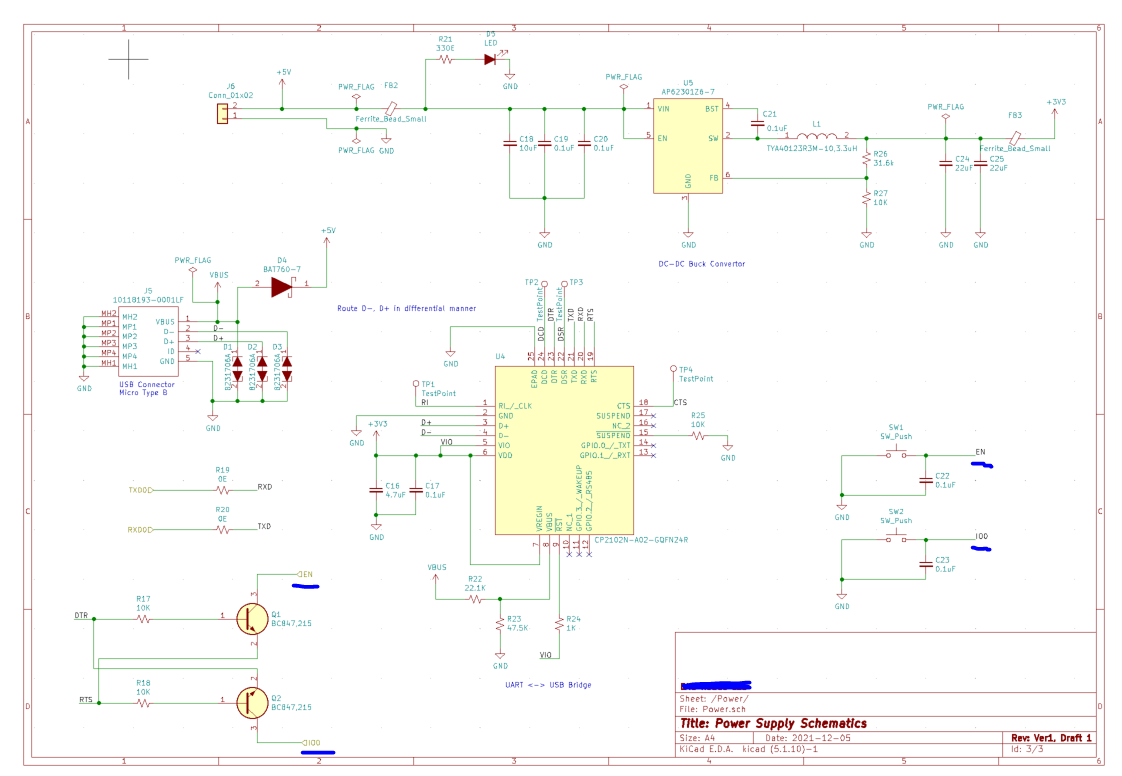

I have designed a custom ESP32 board based on Wroom-32 module for one medical application. However, I am not able to erase it's flash and getting following error.
C:\02-Rahul\01-Consultancy Projects\Process\Software\Test Files - 25-12-2021>esptool --port com4 erase_flash
esptool.py v3.1
Serial port com4
Connecting...
Device PID identification is only supported on COM and /dev/ serial ports.
....._____....._____....._____....._____....._____....._____....._____
A fatal error occurred: Failed to connect to Espressif device: Invalid head of packet (0x1B)
I am using a boot switch to connect RTS <-> EN and DTR <-> GPIO0 as there in https://dl.espressif.com/dl/schematics/ ... 80607a.pdf
I also tried connecting RTS and EN directly and DTR and GPIO0 directly, still facing the same error.
Attached my schematics for reference.
Can anyone kindly check and help me here?

Unless I'm overlooking it in your schematic, I think you're missing the powerup reset EN R/C network. Add a resistor of 10K from EN to Vcc and add a capacitor of 1 to 10uF from EN to Gnd, and you should be good.

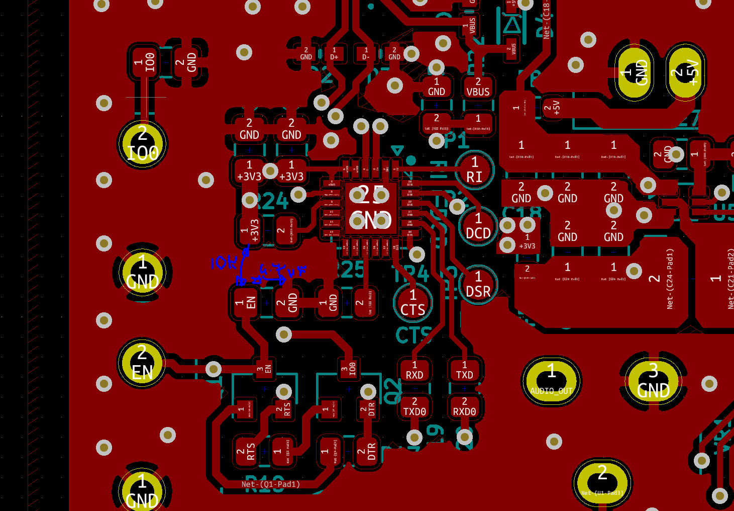

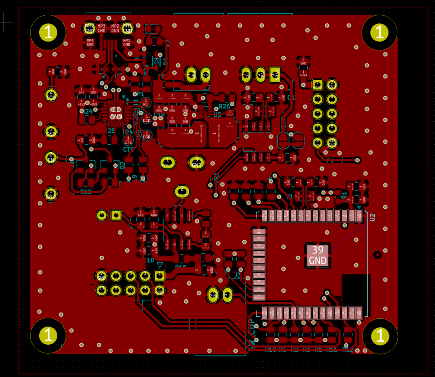

Yes, I missed putting 10k EN RC ckt but even after trying that out, it is still showing the same error. Is it that I need to put this RC near to ESP32 module?
Currently I am putting it at close to CP2102 chip. Check these images.
Top Layer - PCB Layout
PCB layout top.PNG (231.91 KiB) Viewed 22077 times
RC ckt for EN

tried connecting 10k resistor and 10uF cap close to esp32 module, still getting the same error.

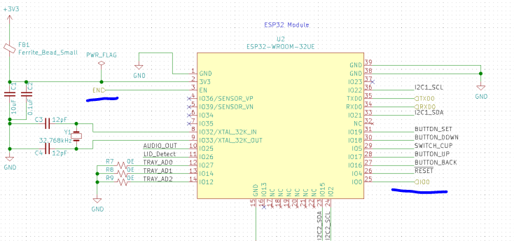

EDIT: Ah, I think I see another issue... It looks like you wired the TxD of the CP2102 to the TxD of the ESP32 and same with the RxD. It should be switched: TxD of the ESP32 should go to the RxD of the CP2102 and vice versa.

I think TXD of CP2102 is rightly connected to RXD of ESP32. May I know where have you noticed that thing?

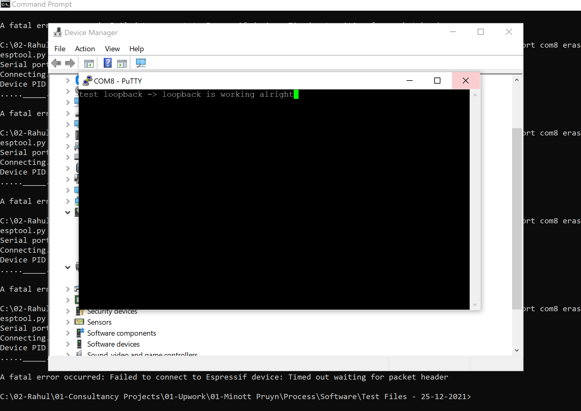

1. Loopback test is working alright for CP2102N IC - disconnected R19, R20 on my schematics and then shorted RXD, TXD of CP2102N and it is working well. Image attached.
2. The module I am using is ESP32-WROOM-32U, so looks like something is wrong on that side.
loop-back test working alright.PNG (120.29 KiB) Viewed 21877 times
