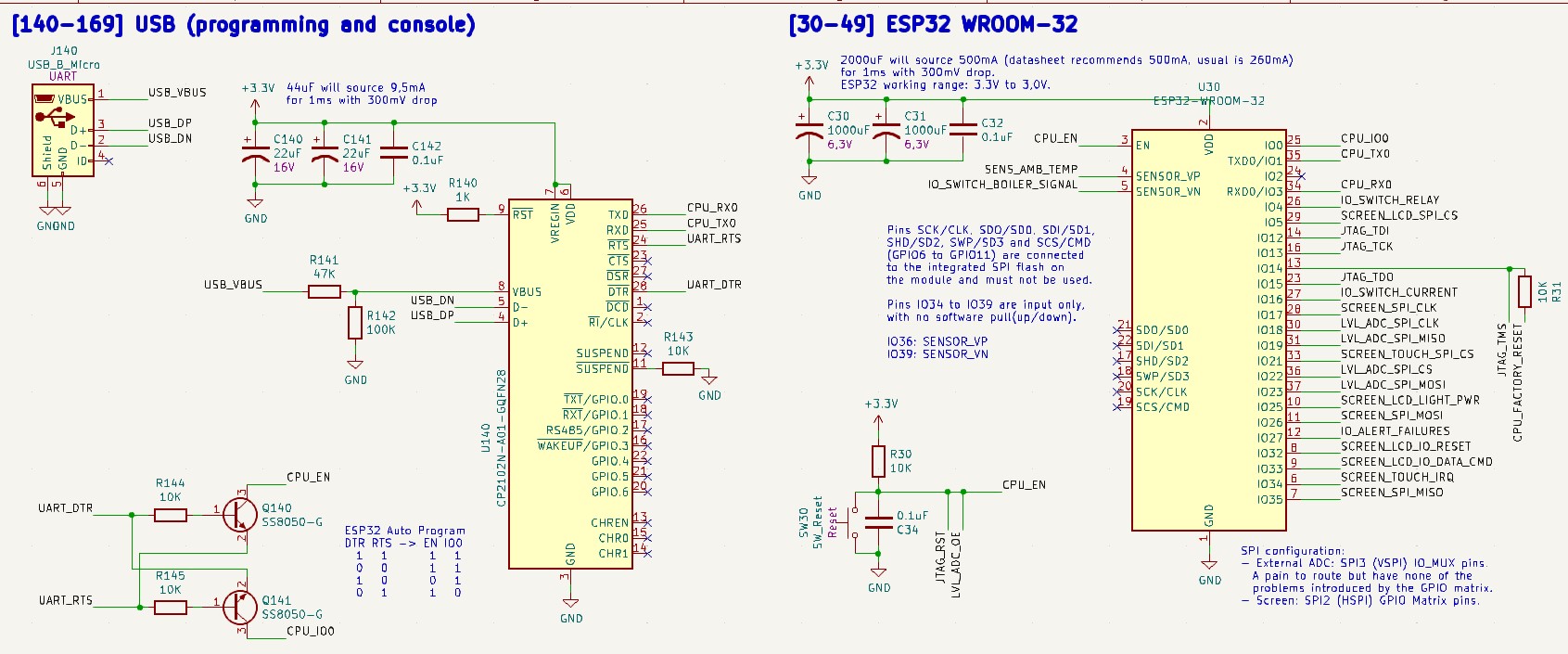

I've designed a custom ESP32 board based on WROOM-32 module for home applications.
However, I am not able to flash it. The board can send data through UART (as shown below) but cannot receive the flash data.
When trying to flash, I get the following error:
Download mode successfully detected, but getting no sync reply: The serial TX path seems to be down.
The USB connection was copied from the esp32_devkitc_v4.
What could be wrong?

Your schematic looks reasonable. Could it be that there is something wrong with the trace labeled CPU_RX0 in your schematic; could you double-check the solder joints and maybe even put an oscilloscope on that pad of the ESP32 module to see if it's active on that side?
EDIT: Also, I would make C34 larger; the datasheet advises 1uF, but you could even try 10uF.

ESP_Sprite, indeed, the problem was the solder joints on the QFN package.
The project was changed to add the 1uF capacitor that you (and the datasheet) suggested.
Thank you very much!
