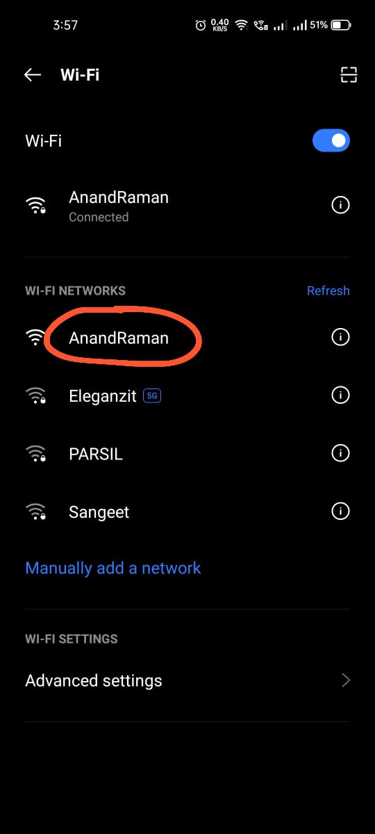

Hello Sir,
I am using ESP32 WROOM Chip. I have configured ESP32 as AP and Station mode same time.
As I configured ESP32 as both modes, For AP mode SSID I have given as "SSID1" and for Station Mode, I have given SSID as "AnandRaman"
I am able to connect the ESP32 station to my home router SSID which is "AnandRaman" and I can get the IP address and the internet
when I am selecting the SSID from my mobile wifi list, I am getting error like I (62922) wifi:max connection, deauth!

Can we connect ESP32 with AP mode and Staton Mode same time ??
error: wifi:max connection, deauth
Please find the attachment. Thanks

is it possible to connect ESP32 Chip with AP Mode and Station mode simultaneously using ESP-IDF? If yes then can you guide me how?

You need to set max_connection field in wifi_ap_config_t:
wifi_config_t wifi_config1 = {
.ap = {
.ssid = EXAMPLE_ESP_WIFI_AP_SSID,
.password = EXAMPLE_ESP_WIFI_AP_PASS,
.max_connection = 5 // If not set the default value is 0, is why you cannot connect
