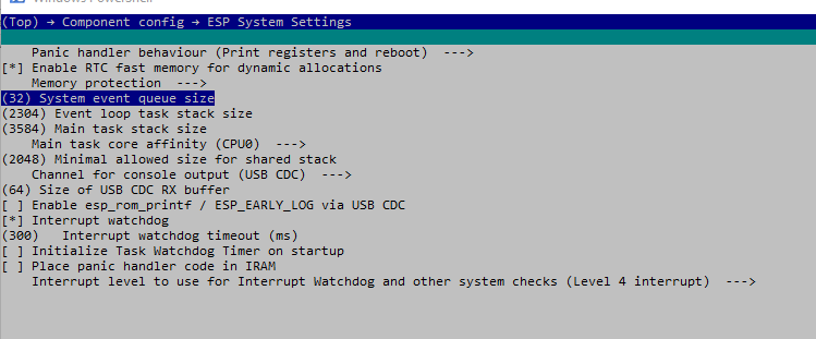

Re: unit-test-app has no COM port
Did you select CDC as your console in menuconfig? If not, it'll try to do the comms over the UART port, and the Feather doesn't have that connected to USB.

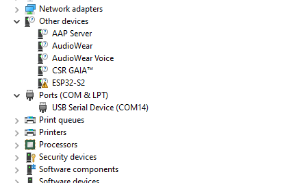

Thank you for responding.
I hadn't done that. But now I have. Still no output from the USB COM port.
I know that when I write an application to log to CDC, I can for sure get serial data on the COM port that enumerates with said app.
COM14 comes up when I hold boot button then reset the chip.
With custom software that uses CDC to log, COM3 shows up on board reset.
If I flash with the unit-test-app, no COM port will enumerate after a reset.
Check out the attached screenshots
- port_enumeration.png (12.1 KiB) Viewed 2552 times
- config_cdc.png (23.73 KiB) Viewed 2552 times
Omgitskillah
- Posts: 4
- Joined: Sun Feb 13, 2022 10:00 pm
I don't think it changes the configuration.
I checked whether the console is diverted to the UART after I switch to CDC. Nothing comes out of UART0 TX/RX.
