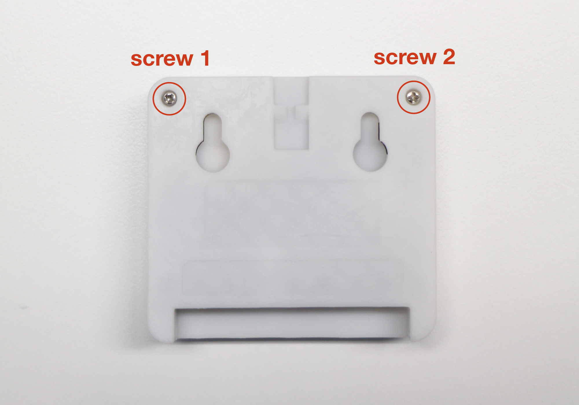

I seem to have received a 'faulty' esp32box with an issue detecting the wake word, i'm sure it a simple HW issue and I am more than happy to try repairing this instead just returning it, I had to wait 5 weeks to receive it.
I have updated it to the latest FW

If you are willing to try to fix it yourself, you can try to disassemble it. The microphones are on a separate board that is connected to the main board with a 6-pin FPC cable; it would probably be a good idea to check if that is still inserted and snug.

hi ESP_Sprite, I have disassemble unit and checked cable and appearance was ok, I removed cable and refitted but unit still didnt respond to sound, as cable is not polarised I reversed cable incase of a bad cable/conductor but still no change.

My unit is same as shown in 'second batch' with 2 screws to rear of case
