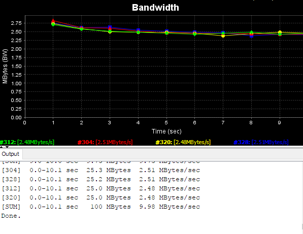

I just like to share that I have the ESP-WROOM32 running with Ethernet at impressive speeds. Running benchmarks using jperf can achieve a throughput of almost 10MBytes/s using 4 concurrent threads:
I think getting 10MBytes/s which is 80Mbit/s on a 100 MBit/s Ethernet link is as good as it gets.

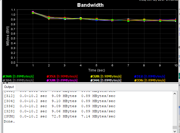

Note: Clockspeed was set to 240 MHz and lwip setting SYS_LIGHTWEIGHT_PROT set to 0. The latter setting is not recommended for normal operation. If SYS_LIGHTWEIGHT_PROT is set to default of 1, bandwidth is around 7 MBytes/s as shown below:

Very impressive!
What ethernet configuration are you using?
ESP32 internal MAC + external PHY?
External MAC + PHY?
I am trying to get ethernet working on my ESP32 with a ENC28J60 using the ESP IDF examples code but pings are only successful a small percentage of the time. I'd love to get your results so any info really helps!
Thank you!
hwmaier
Posts: 31
Joined: Sun May 28, 2017 7:30 am
Re: Impressive Ethernet bandwith using ESP32
Postby hwmaier » Fri Mar 04, 2022 9:26 am
ESP32 internal MAC + external PHY. You won't achieve those transfer speeds with external MACs.
