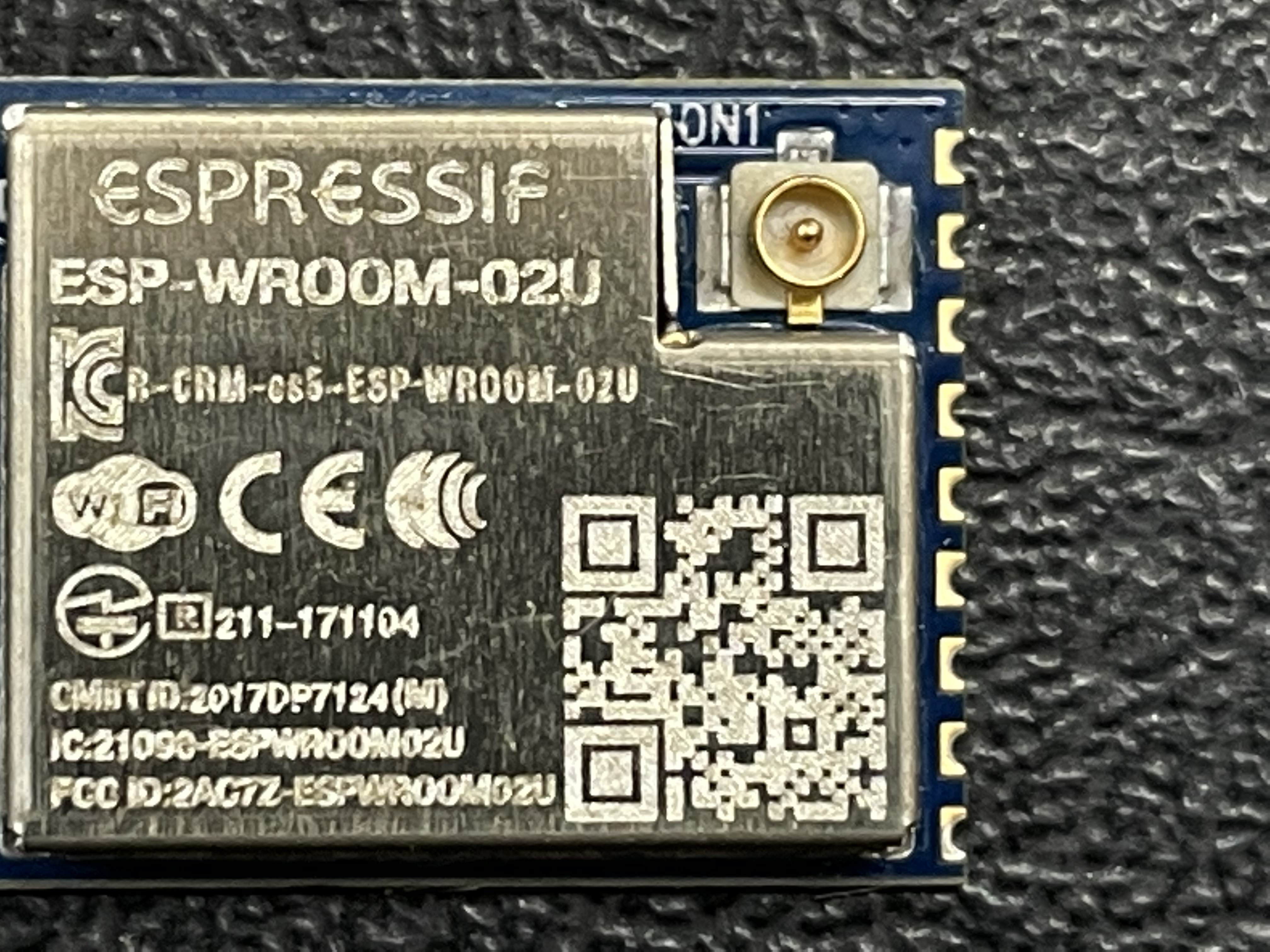

在市场上买到两种丝印的ESP-WROOM-02UWIFI模组?
zenmvol
Joined: Sat Apr 02, 2022 12:21 am
Postby zenmvol » Sat Apr 02, 2022 12:36 am
底部没有厂商丝印,Log信息:ets Jan 8 2013,rst cause:2, boot mode:(3,6)
load 0x40100000, len 2408, room 16
tail 8
chksum 0xe5
load 0x3ffe8000, len 776, room 0
tail 8
chksum 0x84
load 0x3ffe8310, len 632, room 0
tail 8
chksum 0xd8
csum 0xd8
2nd boot version : 1.6
SPI Speed : 40MHz
SPI Mode : QIO
SPI Flash Size & Map: 16Mbit(1024KB+1024KB)
jump to run user1 @ 1000
OS SDK ver: 1.5.0-dev(191728c) compiled @ Dec 4 2017 15:19:34
没有厂商丝印的模块,启动后不响应AT指令,间隔的发出:1616E385E8DE,-84,6,0,0;328ECED216BC,-82,6,0,0;328ECED216BC,-82,6,0,0; 这样的消息,请问如何将此模块,通过刷官方固件,跟后面的模块一样

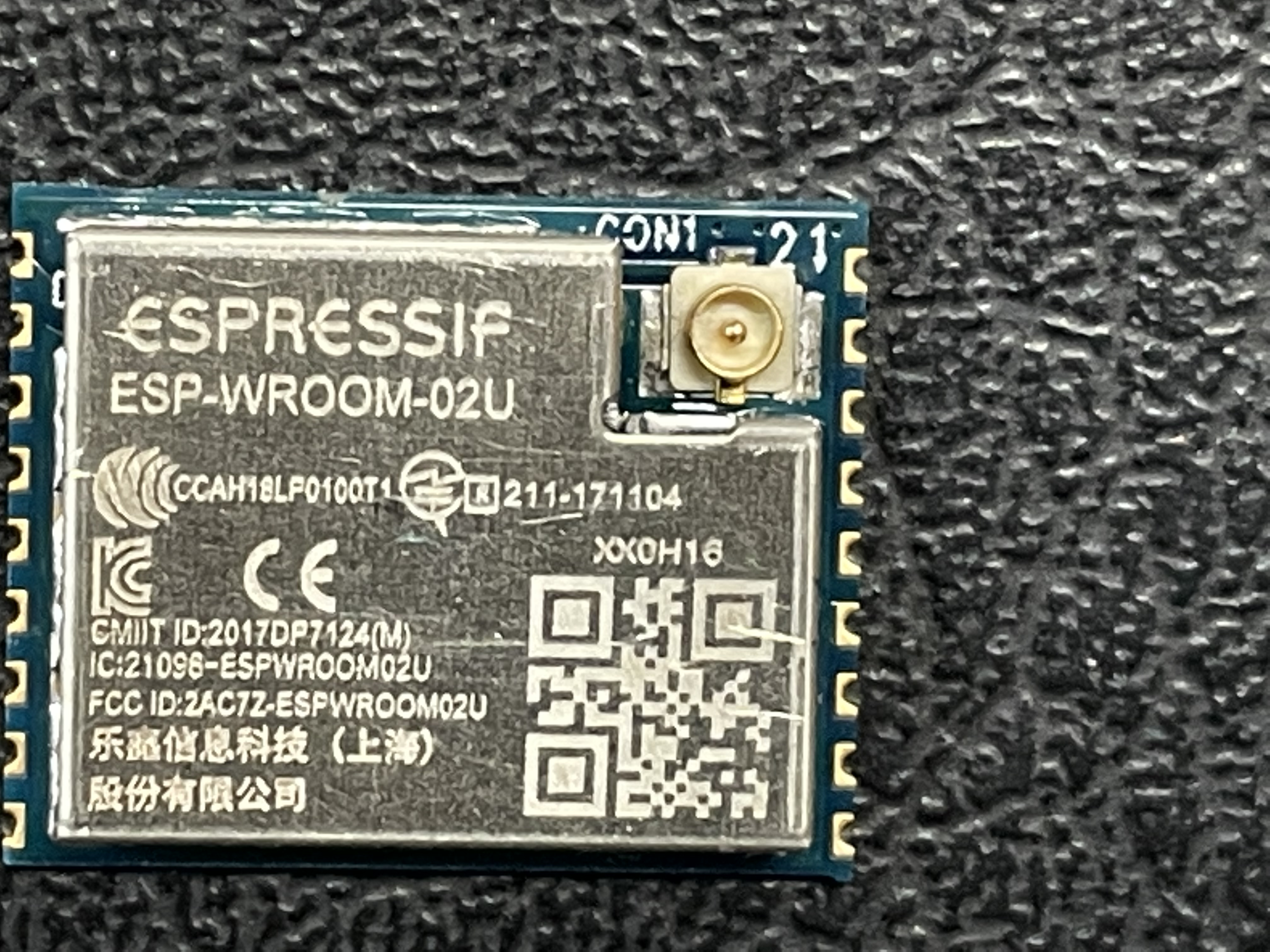

zenmvol
Re: 在市场上买到两种丝印的ESP-WROOM-02UWIFI模组?
Postby zenmvol » Sat Apr 02, 2022 2:15 am
正常的模块LOG信息:
load 0x40100000, len 2524, room 16
tail 12
chksum 0xc3
ho 0 tail 12 room 4
load 0x3ffe8000, len 764, room 12
tail 0
chksum 0xa2
load 0x3ffe82fc, len 756, room 8
tail 12
chksum 0xd5
csum 0xd5
2nd boot version : 1.8(0d7607e)
SPI Speed : 40MHz
SPI Mode : DIO
into flash test mode
fac sec is 1fa
pass flag res:1 mac:bc:ff:4d:39:75:54
�rf cal sector: 507
freq trace enable 0
rf[112] : 00
rf[113] : 00
rf[114] : 01
SDK ver: 3.0.3(8427744) compiled @ Mar 19 2020 18:11:05
phy ver: 1156_0, pp ver: 10.2
AT+GMR查询到的版本信息如下:
AT version:1.7.3.0(Mar 19 2020 18:15:04)
SDK version:3.0.3(8427744)
compile time:Mar 24 2020 16:16:12
Bin version(Wroom 02):3.0.3
