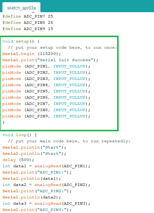

Hi @tommeyers,
Thanks for your response.
I enabled pull-up and still measuring the same 1.6V.
Code screedhot attached

Re: ESP32 - added pull-up to 3.3V but measuring 1.6V
I removed 1Mohm pull-up resistor on one of the GPIO and read 0V.
As we enabled the pullup resistor, the pin voltage is expected to be 3.3V. I am not sure what would be an issue.
Even if i configure the pin as output and make it is HIGH or low, I am reading 1.6V only. Totally weird to me.
Note that pins >34 do not have output or pullup/pulldown capability.

Hi ESP_Sprite,
I configured it as general input GPIO and i have an external pull-up resistor 1Mohm, but still measuring 1,6V only?
I added pullup to 3.3V.
Regards.

Hello All,
It was my multimeter loading the IO lines and reading it as 1.6V instead of 3.3V.
Thanks to all members who commented.
