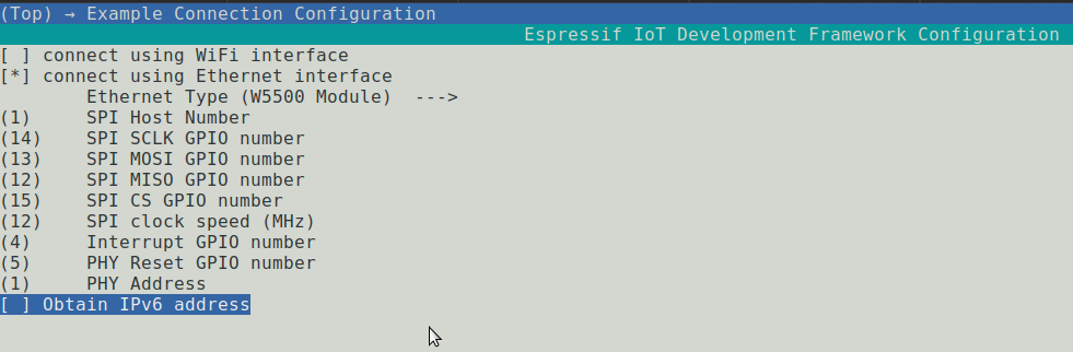

Hello @JonathanJol,
What do you mean under "ESP32 IP address"? Is it the address of the WiFi interface?
The Modbus TCP example uses the example_connect common code to initialize the netif. It supports an ethernet connection over the W5500 driver. The master IP address should be obtained automatically from DHCP in this case. Below are the options set in the Example Connection Configuration menuconfig to use the W5500. If you configured the interface accordingly and selected the
See the https://docs.espressif.com/projects/esp ... on-options for more information on how to configure the Modbus slave IP addresses manually.
If you need, it is possible to change the netif IP and gateway manually using the function below.
in this case, you have to make sure you configured your network correctly and set connection options in your modbus slaves accordingly.
The place where you can change it on master: https://github.com/espressif/esp-idf/bl ... ter.c#L747
You can check the actual network parameters configured for you netif interface using the code below:
If you configured the described options properly, your master should be able to connect to your slave.
The TCP slave network configuration is very similar to what is shown above.
If you still have issues with the connection please share your code example and log.
that corresponds to `CONFIG_MB_MDNS_IP_RESOLVER` kconfig option the master should be able to find all configured slaves in the network and should be able to read data from them.(Top) → Modbus TCP Example Configuration
Espressif IoT Development Framework Configuration
Select method to resolve slave IP addresses (Resolve Modbus slave addresses using mDNS service.) --->
esp_err_t esp_netif_set_ip_info(esp_netif_t *esp_netif, const esp_netif_ip_info_t *ip_info);
esp_netif_t* pnetif = (esp_netif_t*)comm_info.ip_netif_ptr;
esp_netif_ip_info_t ip_info;
IP4_ADDR(&ip_info.ip, 192, 168, 33, 103);
IP4_ADDR(&ip_info.gw, 192, 168, 33, 3);
IP4_ADDR(&ip_info.netmask, 255, 255, 254, 0);
esp_netif_set_ip_info(pnetif, &ip_info);

Hence you need to fix the code as follows:
And remove this:
The above one was the reason why you got random IP address since you passed to the function incorrect memory area which was not associated with NETIF.
Ondrej
I see where the issue is. You misunderstood the ESP NETIF concept. The ESP NETIF is associated with Ethernet handle, it is kind of intermediate layer between IP stack and Ethernet driver, please see https://docs.espressif.com/projects/esp ... netif.html for more info.
mb_communication_info_t comm_info = {
.ip_port = MB_TCP_SLAVE_PORT, // Modbus TCP port number (default = 502)
.ip_addr_type = MB_IPV4, // version of IP protocol
.ip_mode = MB_MODE_TCP, // Port communication mode
.ip_addr = NULL, // This field keeps the client IP address to bind, NULL - bind to any client
.ip_netif_ptr = eth_netif_spi // esp_netif_ptr - pointer to the corresponding network interface
esp_netif_get_ip_info(eth_handle_spi, &ip_info);
ESP_LOGI(SLAVE_TAG, "ip: " IPSTR ", mask: " IPSTR ", gw: " IPSTR,
IP2STR(&ip_info.ip),
IP2STR(&ip_info.netmask),
IP2STR(&ip_info.gw));

@JonathanJol ,
Thank you for your code snippet and clarification. The code you provided is fully functional and Modbus communication with the static IP can be established once you set the netif interface correctly in the Modbus slave configuration as @ESP_ondrej described above.
Try to set it as described and let me know your result.

Hello, @ESP_alisitsyn and @ESP_ondrej
Thank you very much for your answers, I have successfully reached communication with my ESP32 as a slave. It was not immediate though, after applying the fix I still struggled to get things going, so I went straight to day 0 and compiled an ethernet basic example which worked as intended. This made me compare both my code and the example to make sure I didn't forget a tiny detail, here are my findings:
1-. I never told you what was the ESP-IDF version I was working on, which is 4.3.1. I think this was very important for the following reason.
2. The esp_eth_set_default_handlers function was missing from my code, since the example of the v4.4 doesn't have it in it.
Just to give you context into why I was using a v4.4 example in this, I'm working in a remote Raspberry Pi environment that is using v4.3.1 since v4.4 can't compile for another known error. On my local PC, I was working using the examples in the working environment I have and then sending files through WinSCP. When I did the basic Ethernet example I used the example inside the RPi environment, so that is why it worked immediately.
I take that this is my error since I haven't seen anyone talking about the missing function in v4.4, but just in case, can you guys confirm to me that v4.4 is not necessary to call for esp_eth_set_default_handlers?
Thank you!
Thank you!
Re: Modbus TCP Slave + W5500 static IP information
Yes, it is not necessary to call `esp_eth_set_default_handlers` in ESP-IDF 4.4 and higher.
