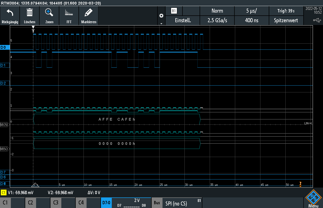

Hi, I'm currently trying to receive data via SPI on the ESP32 (Slave), sent by a STM32 (Master).
There's no CS and no Handshake available, so there are only CLK, MOSI and MISO.
The data sent by the master (0xAFFECAFE) seems correct to me:
D0 = CLK = GPIO18
D1 = MOSI = GPIO23
D2 = MISO = GPIO19

(I can control the sending on the master by pressing a button)
What happens is, that spi_slave_transmit get's called and then spi_ex_setupCplt. After that I'm sending 0xAFFECAFE from the master by hand, but it seems like it hasn't any effect on the slave. spi_slave_transmit keeps blocking and neither spi_ex_setupCplt nor spi_ex_transactionCplt are getting called.
If I'm correct, I should also see 0x55555555 on the MISO line while sending, since I filled spi_ex_3txBuf with 0x55, but it's low during the transaction.
I've read the whole description (https://docs.espressif.com/projects/esp ... slave.html) and had a look at the example (https://github.com/espressif/esp-idf/bl ... app_main.c), but i cannot get it working.
Thanks in advance!

Let me share my results with you:
At first the most important info: You need a CS for an ESP32 as a SPI slave, if you don't want to overcomplicate your software.
1st issue I had:
What the ESP32 IDF really needs is the end of the transaction as a rising edge on CS. Else it doesn't know when the transaction is completed. Usually the length of a SPI transaction is fixed for slaves (8-32bit), but with IDF you could theoretically (if the buffer is large enough) receive "endless" bits in one transaction. For microcontroller to microcontroller communication this is kind of nice (I have to admit that), but since it is very unusual it cost me a lot of time debugging.
Without a CS line the data is received into the receive buffer and the data in the transmit buffer is transmitted, but you will never get a callback and spi_slave_transmit keeps blocking. Maybe you could use spi_slave_queue_trans and constantly check the receive buffer for data, but that is what i mean with "overcomplicating software".
=>Since it's very unusual to use CS like that, it would be nice to mention that in the documentation (https://docs.espressif.com/projects/esp ... slave.html). "spi_slave_interface_config_t" => "spics_io_num"
