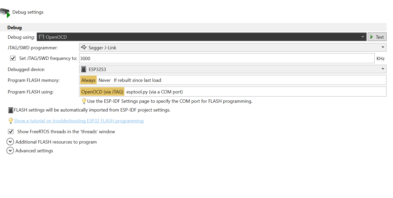

I am trying to debug my ESP32-S3 in DevkitC using J-link. but I am not able to connect the way I am used to do in ESP32-WROOM32E.
I reffered the IO connections as per the data provided here: https://docs.espressif.com/projects/esp ... itc-1.html
I am using Visual Studio with Visual GDB extension.
Debug settings for ESP32 is shown in attachments
Debug settings for ESP32-S3
Error message shown :
C:\Users\APRASAD\AppData\Local\VisualGDB\EmbeddedDebugPackages\com.sysprogs.esp32.core\bin\openocd.exe -c "gdb_port 64550" -c "telnet_port 64548" -f interface/jlink.cfg -c "adapter_khz 3000" -f target/esp32s3.cfg -c "echo VisualGDB_OpenOCD_Ready"

Error: JTAG scan chain interrogation failed: all zeroes
Error: esp32s3.cpu0: IR capture error; saw 0x00 not 0x01
Warn : target esp32s3.cpu0 examination failed
Warn : target esp32s3.cpu1 examination failed
Info : starting gdb server for esp32s3.cpu0 on 64550
Info : Listening on port 64550 for gdb connections
Info : accepting 'gdb' connection on tcp/64550
Error: Target not examined yet
Error executing event gdb-attach on target esp32s3.cpu0:
Error: Target not halted
Error: auto_probe failed
Error: Connect failed. Consider setting up a gdb-attach event for the target to prepare target for GDB connect, or use 'gdb_memory_map disable'.
Error: attempted 'gdb' connection rejected

Same issue, different board -> https://www.esp32.com/viewtopic.php?f=12&t=28642
Have you burned the fused yet? If not, read this
https://docs.espressif.com/projects/esp ... -jtag.html
