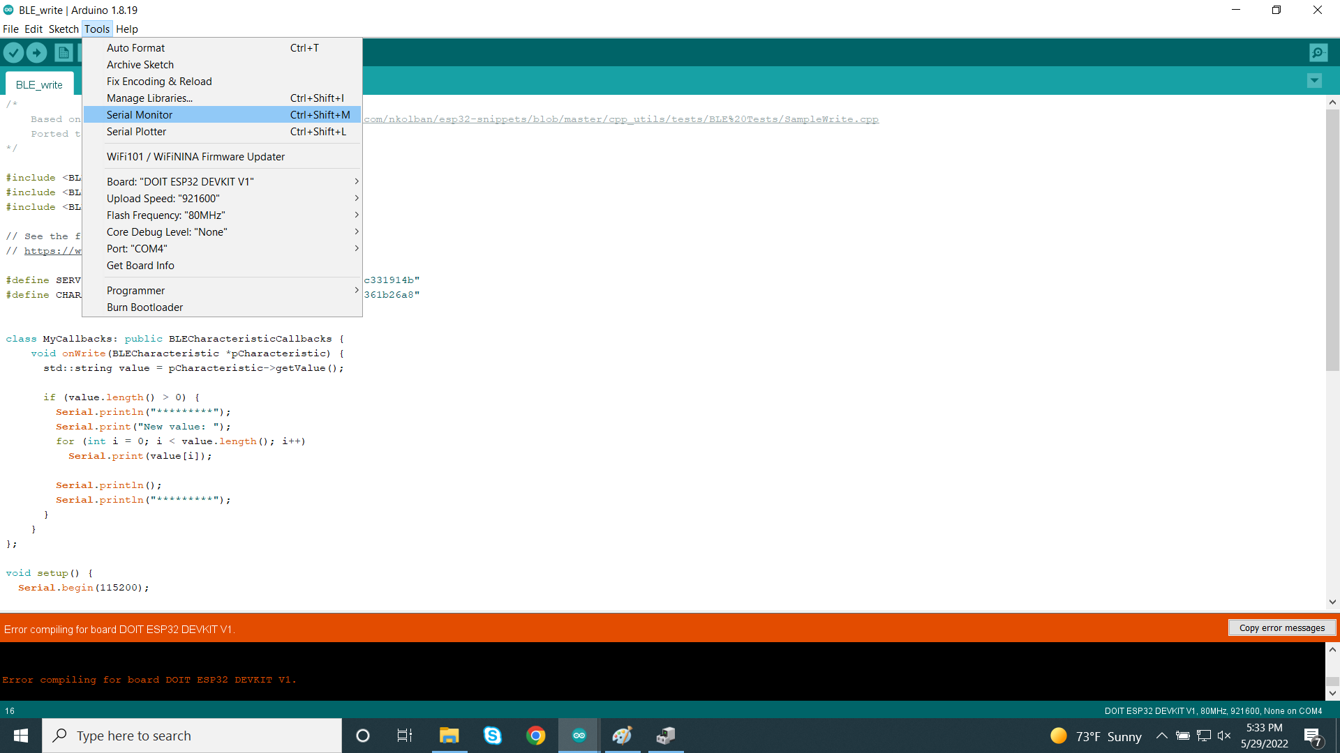

Hello, I just installed Arduino IDE for Windows 7 and newer (using windows 10). I installed support for the ESP32, selected DOIT ESP32 DEVKIT V1 and selected the ESP32 BLE Arduino EXAMPLE: BLE_write. It compiled the first time but when I went to upload I got an error:
Error compiling for board DOIT ESP32 DEVKIT V1
Can you help me figure out what is going wrong?
Thank you

See where it says "Copy error messages"? Hit that button and paste it into Notepad. I'll bet it has a lot more information about why it failed. You can also scroll down there, or expand the lower section with the errors.

When I push, Copy error messages, I get:
Arduino: 1.8.19 (Windows 10), Board: "DOIT ESP32 DEVKIT V1, 80MHz, 921600, None"

Error compiling for board DOIT ESP32 DEVKIT V1.
Re: Arduino IDE new install Compile Error with unaltered example
what thoughts or suggestions do you have?

Put your sketch folder somewhere other than OneDrive. There are limits on the filepath lengths, and spaces never help in filenames.
