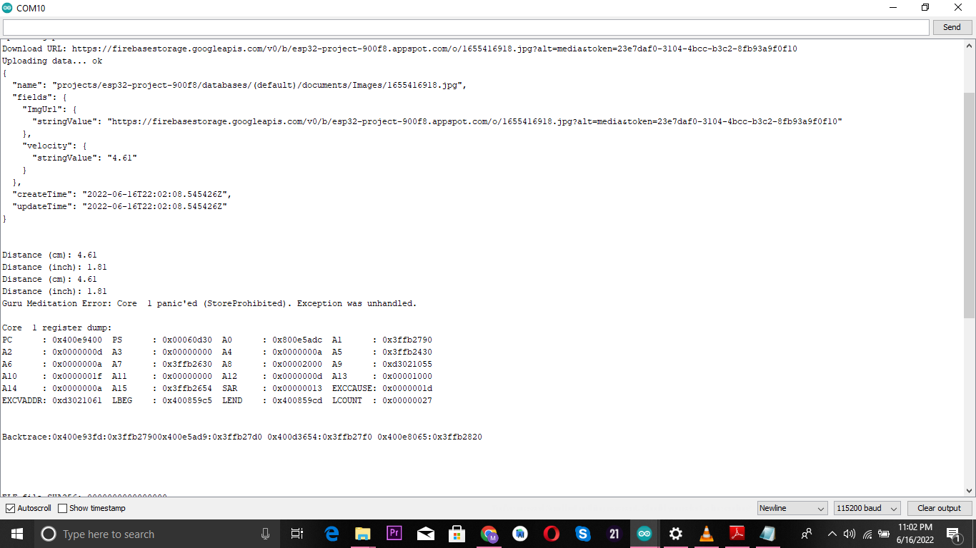

Hello
I am trying to develop a motion detection system using the esp32 and an ultrasonic sensor.
Everything is working fine except after the pictures/data are uploaded to firebase, it throws an error "Guru Mediation" reboots , runs the loop again sends the image throws the error repeatedly. Below is my code

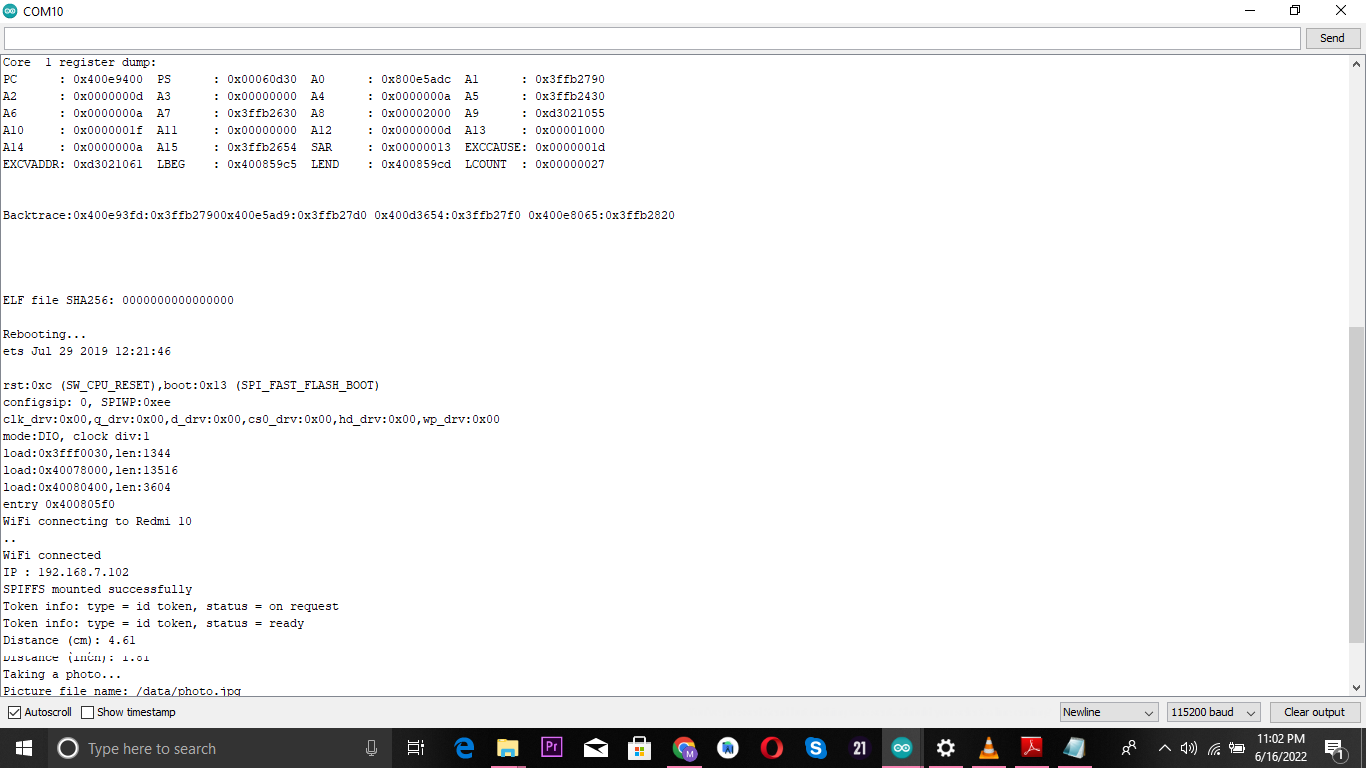

This are the errors i got
Screenshot (251).png (91.13 KiB) Viewed 4562 times
Screenshot (250).png (93.47 KiB) Viewed 4562 times
Using the Esp decoder i inputted the backtrace but i dont seem to get the issue
Decoding stack results
0x400e93b0: gpio_set_level at /home/runner/work/esp32-arduino-lib-builder/esp32-arduino-lib-builder/esp-idf/components/hal/esp32/include/hal/gpio_ll.h line 427
0x400e5ad9: __digitalWrite at C:\Users\ACER\AppData\Local\Arduino15\packages\esp32\hardware\esp32\2.0.3\cores\esp32\esp32-hal-gpio.c line 126
0x400d3660: loop() at C:\Users\ACER\Desktop\speed/speed.ino line 253
0x400e8065: loopTask(void*) at C:\Users\ACER\AppData\Local\Arduino15\packages\esp32\hardware\esp32\2.0.3\cores\esp32\main.cpp line 50
Please help as this has been disturbing me for days please
