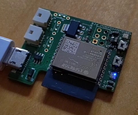

just got some pcbs and asselmbled them with some modules...
these boards have the USB-Port connected directly to the ESP32 C3 USB_CDC port.
i also updated the esp board package to 2.0.2.
the hardware reported during upload:
esptool.py v3.1
Serial port /dev/ttyACM0
Connecting...
Chip is unknown ESP32-C3 (revision 3)
Features: Wi-Fi
Crystal is 40MHz
MAC: 7c:df:a1:b3:b6:80
so the same as the dev-board i have.
and it is the same behavior - as fare as i tested -
i can upload with the USB_CDC port.
but get no serial output.

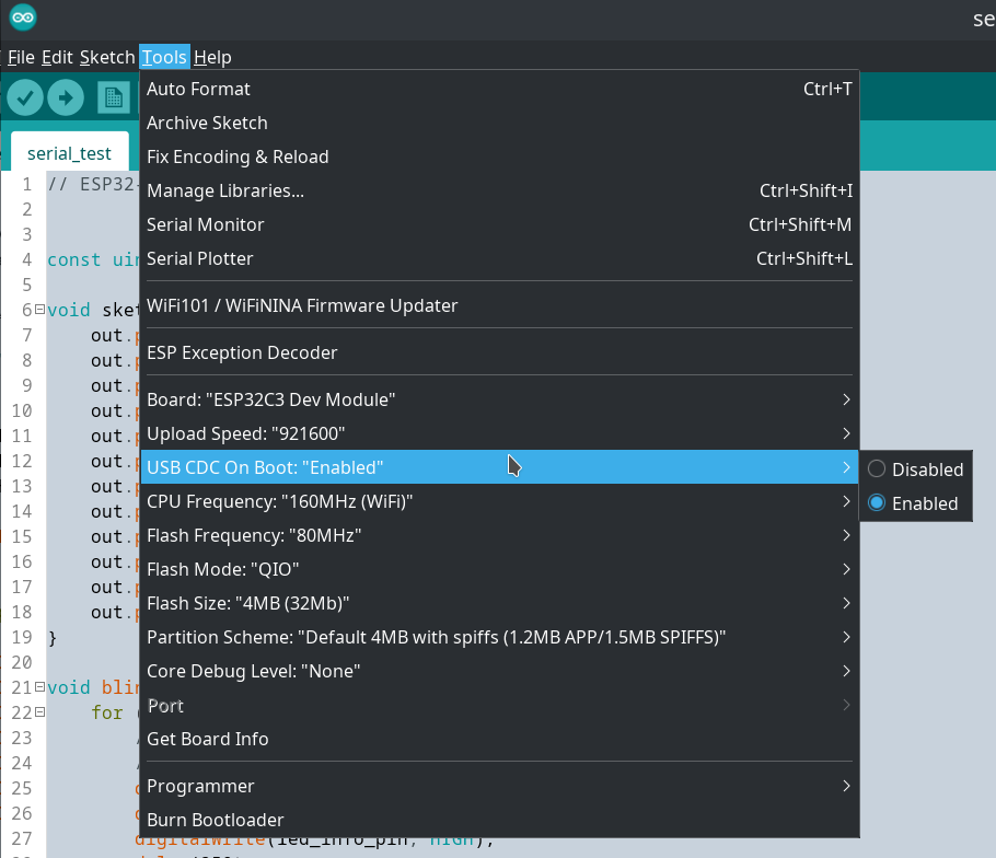

the `ARDUINO_HW_CDC_ON_BOOT` can be activated via a gui menu option.
Arduino 1.8.19 ESP32-C3 USB CDC On Boot.png (93.96 KiB) Viewed 35870 times
this option can be found at
platform.txt#L63
build.extra_flags.esp32c3=-DARDUINO_HW_CDC_ON_BOOT={build.cdc_on_boot}

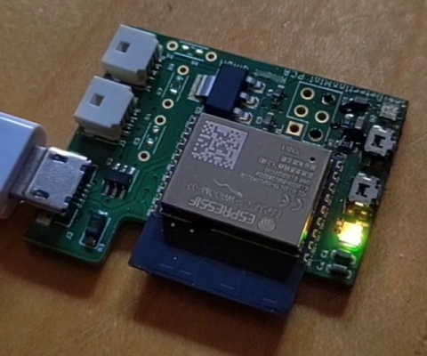

Test Setup
both ports connected.
one is showing up as ttyACM0 - that is the HW USB_CDC
the other as ttyUSB0 - that is the USB to UART chip CP2102N
on pin 1 is a led connected.

1 HW_CDC_ON_BOOT = FALSE
config:
#define SerialUART Serial
#define  SerialCDC USBSerial

2 HW_CDC_ON_BOOT = TRUE
config:
#define SerialUART Serial0
#define  SerialCDC Serial

Postby s-light » Tue Jun 21, 2022 3:30 pm
seems for me the last board-package update fixed things :-)
now with 2.0.3 it is working as expected.
if i set Tools → `USB CDC on Boot:"Enabled"` and use `Serial.println("Hello World")` i get `Hello World` on the CDC device :-)
