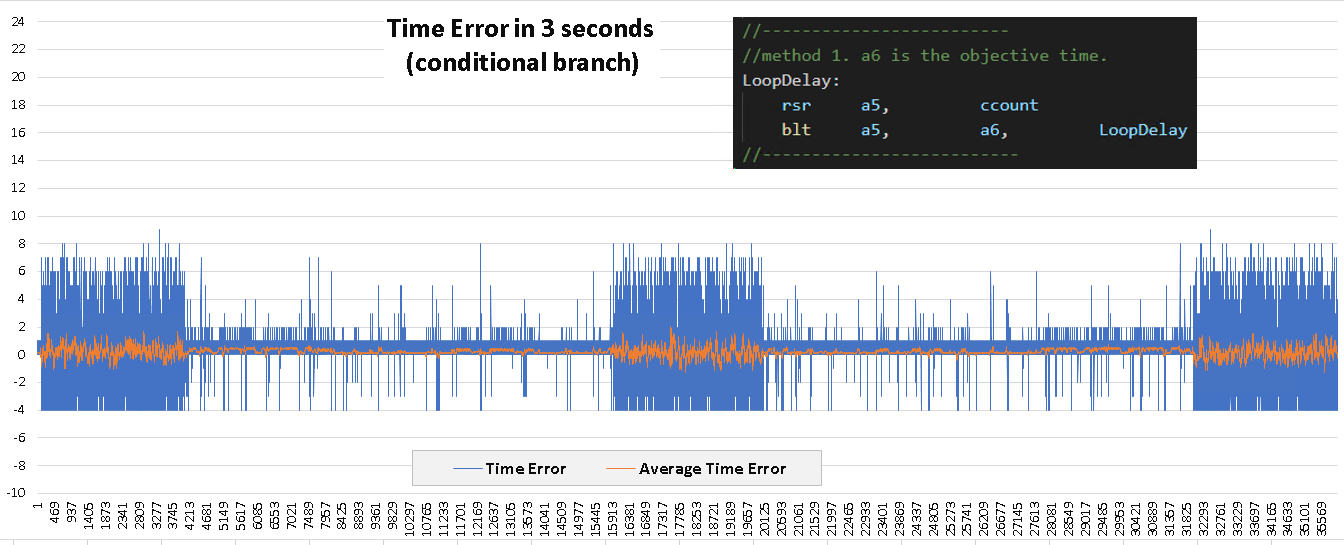

In the high-priority interrupt I tried to delay the command by exact CPU cycles. But it seems the best accuracy of CPU delay I can get is 7 CPU cycles.
I have some code that requires low interrupt jitter. Even with level-5 interrupt jitter still exists, and the jitter can be 23 CPU cycles caused by some uncontrollable WiFi task. To reduce the jitter, I set the timer 100 CPU cycles earlier than the objective time, then delay the commands in the handler until the real objective time arrives. (The same concept can be found in some STM32 chips to reduce/avoid jitter by introducing some delay)
In the interrupt handler, I compare the ccount with the objective time in a loop until the objective time is current. However, each iteration of the loop takes 7 CPU cycles, which limits the accuracy of the delay. I'm wondering if there is any other command or workaround to further improve the accuracy.
An example of the logic is shown below. command 'rsr' takes 1 cpu cycle, and branch command 'blt' takes 6 CPU cycles. When the aforementioned uncontrollable WiFi task run, one iteration of the loop could take up to 12 CPU cycles. Is that normal?
//level-5 interrupt handler
    movi   a6,	   100					//The objective time
LoopDelay:
    rsr     a5,         ccount
    blt     a5,         a6,         LoopDelay         //if current time < timer setting, loop back to wait.
    //other commands that require low jitter.

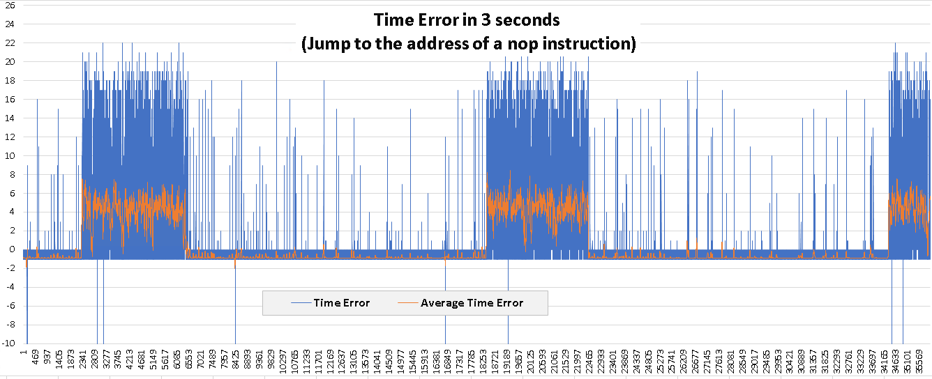

Another thing I thought of: perhaps a computed jump can help you here? Pseudo-code because my Xtensa assembly is rusty:
	mov reg, 32 ;amount of nops in table
	sub reg, cycles_to_delay
	mul reg, sizeof(nop_instruction) ;iirc 2 or 3 bytes
	add reg, nop_start
	jmp [reg]
nop_start:
	nop
	nop
	[.. total of 32x nop]
	nop
	nop
end: //we should be precisely on time here
To make the nop table small enough, you can 'burn' cycles by doing a normal loop before that.

The method works as expected, but didn't resolve the problem.
It does execute a various number of nop. The problem is jitter happens when it executes the series of nop instructions(less than 32), making the final time not accurate. The time error of the method is attached below. Every 1.33 seconds there is a 0.3s window when the jitter is very large. A series of nop instructions is a kind of open-loop control without any feedback. I also attached the branch loop, which is a control with feedback, and the result is a little bit better. Similarly, if loopgtz worked in the interrupt handler, I believe it will be better than loop.
Do you have any idea what could cause these 1.33s periodic windows? Is it possible to temporarily disable all other higher level interrupts or tasks in the interrupt handler, like the taskENTER_CRITICAL of FreeRTOS?
Result of the method of a series of NOP instructions:
jump .PNG (76.56 KiB) Viewed 6007 times
Result of conditional branch:
