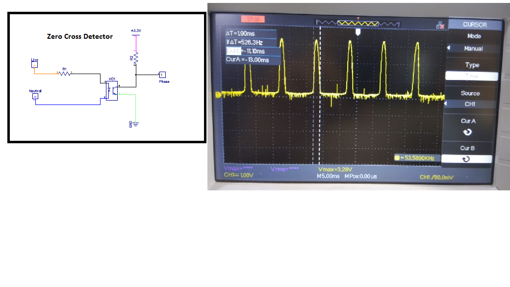

Dear All,
Look at the below code, it is Phase controlled. But it does not work.

HARDWARE : ESP-WROOM32
OPTO BASED BASED ZCD HARDWARE (see attached diagram)
AC Frequency : 50HZ, 230V
FOLLOWING ARE THE ISSUES:
1. Zero Cross Detector Interrupts are generated for multiple times : 33usecs, 1.3ms and 8.7ms. How to avoid such extra interrupts ? I need interrupt only for 8.7ms
Any Input in this direction would be great...I am using ESP32-Arduino for programming.
