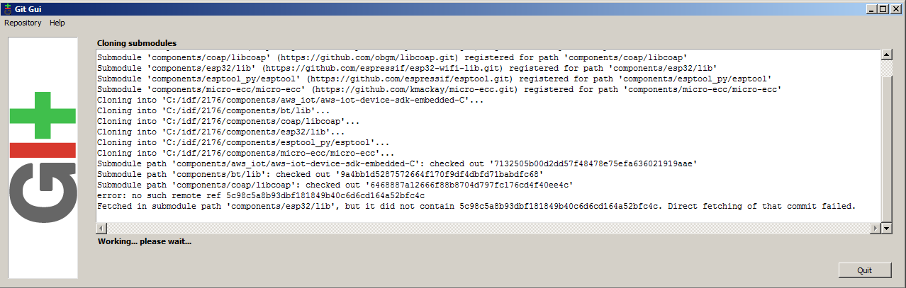

only for info
fetch with sub modules fails just in time
( helped by hand )
will test it - thank you!!

Re: Pulse Counting and sleeping
Hi rudi, thanks for the heads up regarding missing submodule. Please try again, should be fixed now.
hi ivan,
thanks for fast response and fixed - now ok.
rudi
