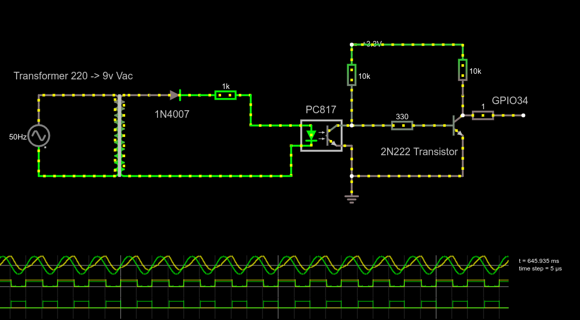

The problem was fixed by inverting the Signal , not by any software changes .
It looks like if you hold an INPUT PIN high , you get that behaviour
but if you invert the signal "which I did" , it works with no problems
Have no idea why is that , but the circuit is here and also the code ,so any one interested ..you can try it .
below is the complete circuit for anyone interested
the 2 10K resistors are connected to the 3.3v supply , sorry if that is not very clear (I'm a software guy)
Power for PIC817 and 2N222 is NOT from ESP
2n222 was used to invert the signal and that solved the problem .
as for PCNT , LEDC .. , Those are very good for HIGH Frequencies .. not for 50Hz , it's an overkill for such low frequency
besides I got double that frequency accurately with 2 ESPs
and again the Sketch to read is simple while loops to measure the wavelength
I did put it in a Task , but that is not even necessary , it can be in the main loop and it will give the same results

The likely cause of issues is a slow rising edge. The usual solution is to implement a schmitt trigger. Which the second transistor will act like.
