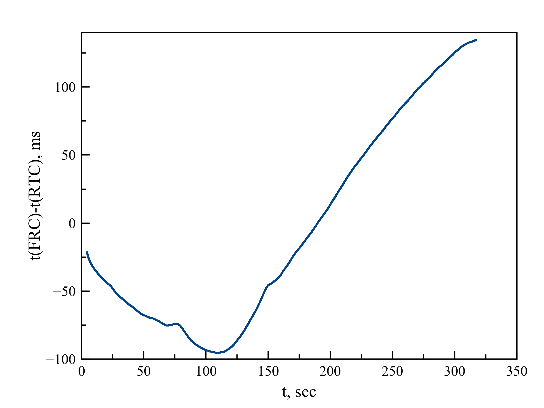

RTC seems to gain 0.8-1.1sec/min on FRC1 in normal runtime mode.

Calibration might still be messed up? Okay, will debug that as well.

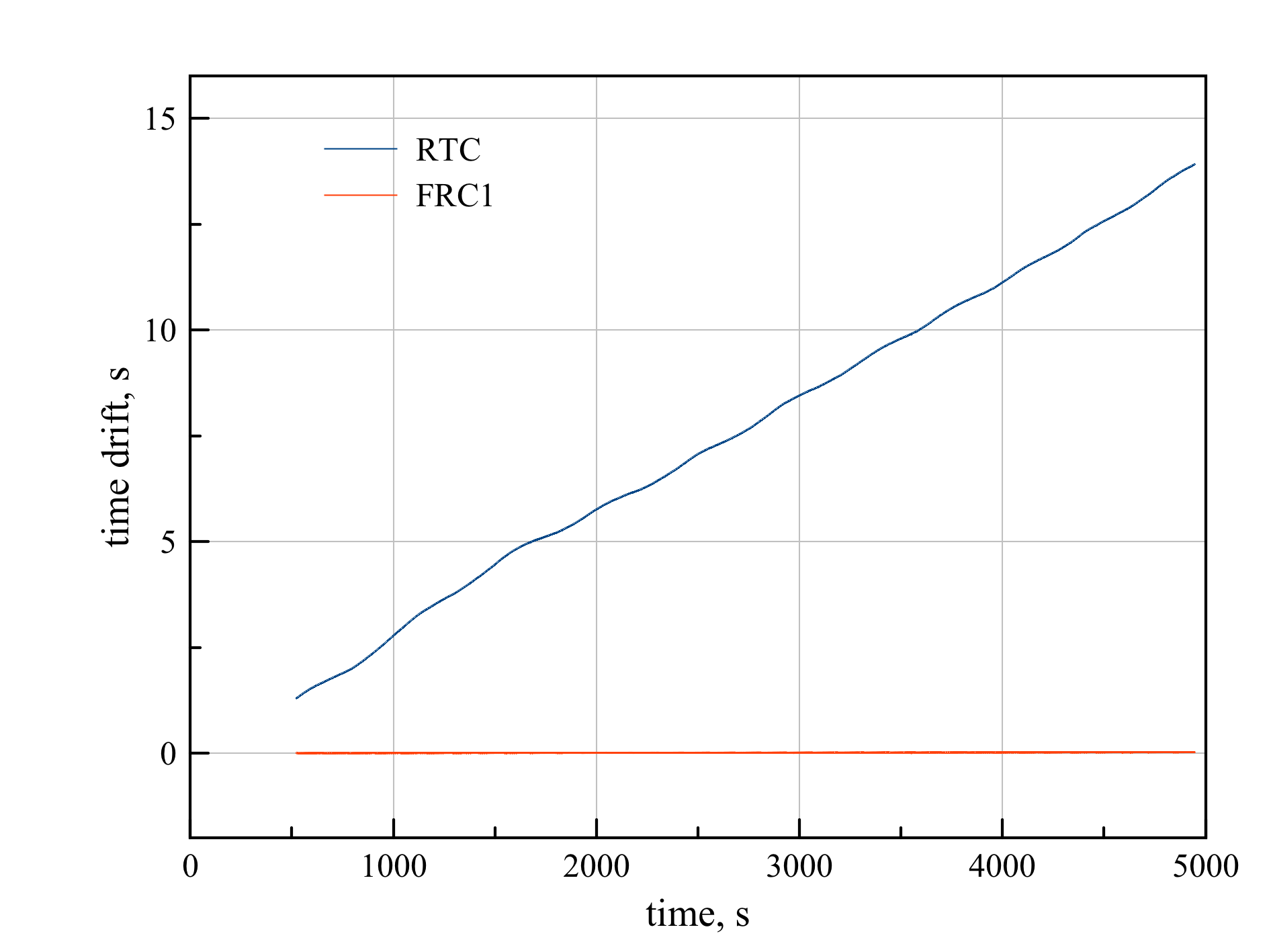

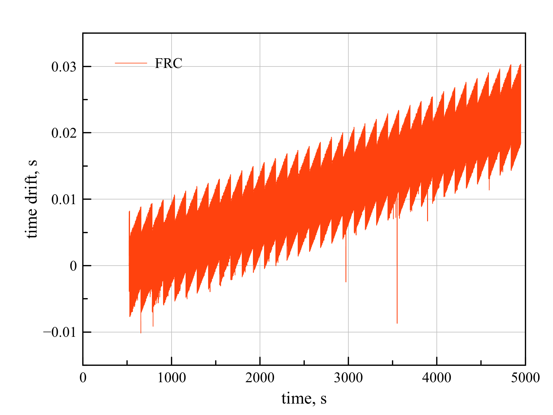

igrr
Posts: 2077
Re: Why does get_rtc_time_us() truncate the result to uint32_t?
Postby igrr » Mon May 22, 2017 9:36 am
Also s_microseconds rolls over at 32-bit.
Can't reproduce this here, can you hint at how you got these results?
Attached are graphs of RTC/FRC timers offset w.r.t. the timer on a PC.
RTC time was obtained from system_get_rtc_time, FRC time — from get_time_since_boot
