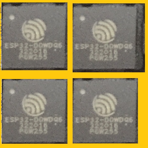

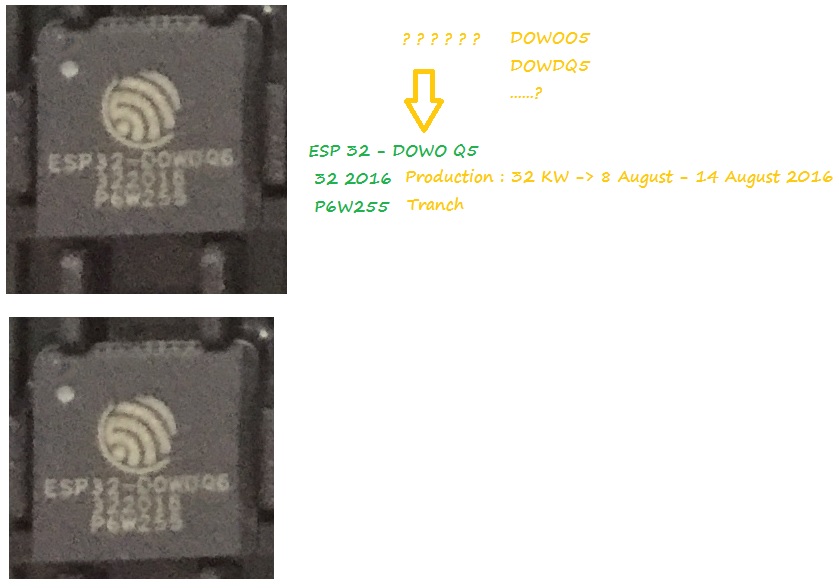

Postby rudi ;-) » Thu Sep 01, 2016 3:16 pm
what can it stand for?
someone knows more`?
edit:
ESP32-DOWD Q5
ESP32-DOWD O5
ESP32-DOWD Q6
ESP32-DOWD Q6

hi guys
for what stands:
ESP32-D0WDQ6
here is the ansere:
D: Dual core
0: no internal flash
WD: WiFi+Dual-Mode Bluetooth
Q6: 6x6 QFN
There are variations on all of these
