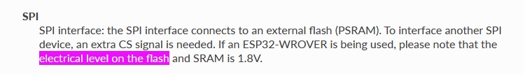

from the readthedocs
the standing theme 1.8V from flash and psram speak detailed 1.8V:
alternate: but we can use 3.3 flash and 3.3 pSRAM-32 too right?
it is not a must2take 1.8V doing, or? then there is no need to use bootstrap or efuse.
does this Interfering ULP or deep sleep?
rudi
ESP-64 then support 64MBit pSRAM 3.3V - and 64MBit pSRAM 1.8V too ? )
rudi
