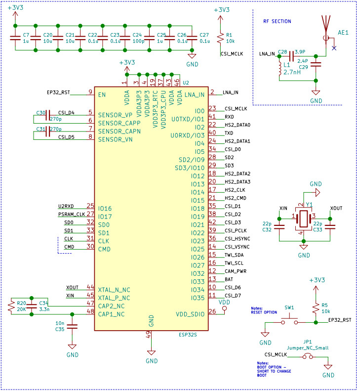

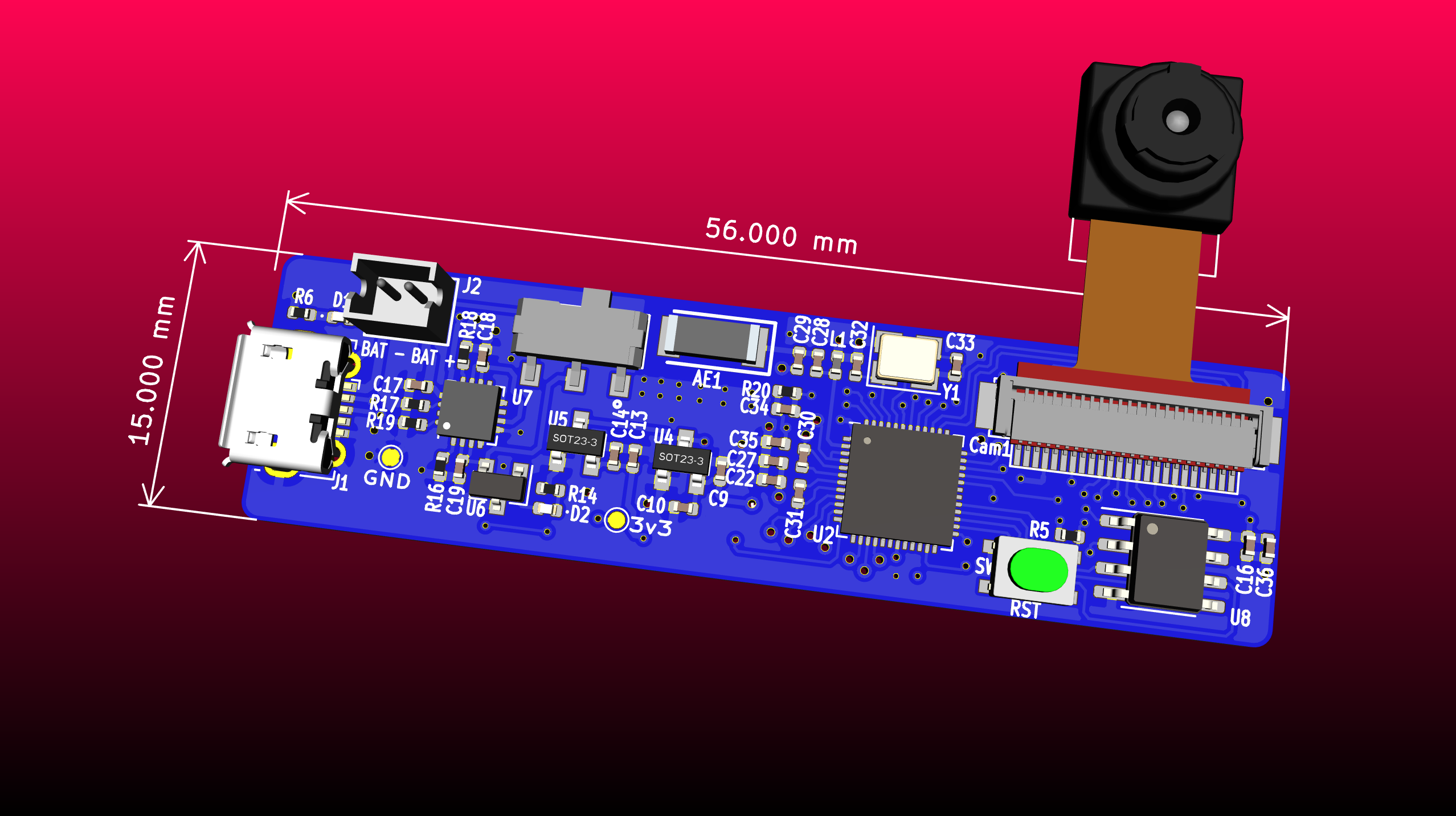

That sounds promising but my board doesn't have pins, as such. Here is the physical layout and the schematic for the ESP32. What should I be doing and how?
Thanks very much.

Postby WiFive » Mon Feb 08, 2021 3:44 pm
You have to press the reset button while shorting JP1

So, since posting the last post, I've done a bit of research and had a further look at the schematic from the designer. According to the esp32 documentation, it looks like there are a couple of options for getting the board in to boot mode. One of which is to send GPIO0 to ground. When I looked at the pcb diagram again, I could see that there is a jumper to set to allow that to happen.
However, I've tried it in a few different ways, for example with the reset button, but it is still timing out. Anyone have any ideas what to try next or which combination to try?

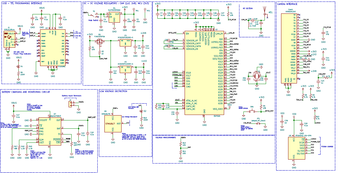

Hmm... I have a meter, so I can check voltages. I don't have a scope and I don't really know what a logic analyser is.
In the meantime, here is the full schematic.

Postby WiFive » Tue Feb 09, 2021 8:55 pm
Check for 3.3v, make sure the switch is on, and try with a battery connected. It looks like there might be a mistake connecting vbat+ to the vreg instead of vbat_out

Postby lannocm » Tue Feb 09, 2021 9:05 pm
Hi, can you explain a bit more please? Are you referring to EN1 on the battery charging circuit? Where is VREG? What is VREG?
Thanks
WiFive
Posts: 3529
Re: New ESP32 Board Bootloader
Postby WiFive » Tue Feb 09, 2021 10:24 pm
u1 the voltage regulator
Also there is no flash chip on the schematic so are you using esp32-u4wdh?
