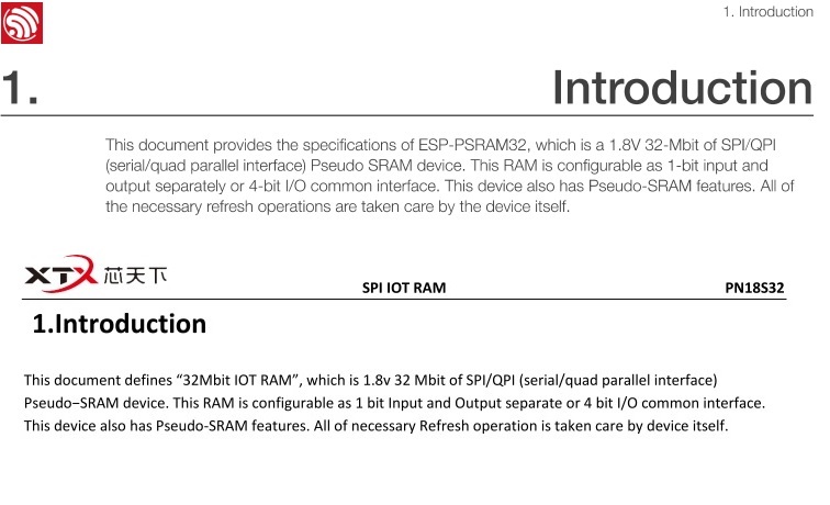

one thing i do not understand, perhabs you can help in this way with an Info about,
i know - you are very detailed and you are visionaer - so i ask you for hope to get answers:
in the technical reference there is a picture, that psram share CLK with flash
you know.
we know now, that this picture must be wrong, cause CLK need to separate for psram. and here comes the same confirm
- at first, can you confirm, the picture is wrong?
- does this mean, that only the workaround need this for rev1 or is this gerenally for the psram then?
we know now, that the pins on this picture must be wrong then too ?! ,
cause the pic shows DI, DO, WP and HOLD QIO mode
but in the pSRAM support, we use DI, DO and WP ( mode ? )
this is a diffenet mode -
hold is not named and not use.
i ask for the mode, cause we have 1 bit Input and Output separate or 4 bit I/O common interface
1 bit Input and Output separate means DI, DO right?
and
4 bit I/O common interface means SD_0..SD_3, right?
btw XTX sales espressif brandmarked pSRAM - so i think - it is the same
from the future/psram-maloc

in which mode the pSRAM then comes to rev1 in this ?
and which mode you would use for the non-flash-cache-based psram access then?

i think i go now "play" bit bang with pSRAM on this way again
btw not sure for what we use /WP in pSRAM
this is not mentioned in the pSRAM Datasheet
PR is here
Re: ESP32 PSRAM support
Posted: Sun Jun 04, 2017 7:28 am
by Sprite
Please refer to the actual documentation of the specific pinouts, like the relevant documentation of external RAM in esp-idf or the psram code itself, for the pinouts. Sentences like 'GPIO17 and GPIO16 are used as CS and CLK' are only meant to illustrate that these two pins are in use, they are not meant to derive a pinout from (we'd use 'respectively' in that case to indicate there's an 1-to-1 match.)
The WP pin is in use because the PSRAM also allows quad-IO mode, with data going through DI, DO, WP and HOLD at the same time.
The datasheet illustrates the general case for adding an extra RAM chip to the flash bus. In this case, however, because of an incompatibility of the requirements between most flash chips and the specific type of RAM-chip that is the ESP-PSRAM32, we also need a separate clock line.

info about the pin function is swapped - what is right or not right - we do not know, one part must here change.
sory for the hint from me that there must be a wrong part or swapped pins.
it is important to connect the things right,
a clk do pulse the data where the cs pin do select only the device for active or not one time in data action.
i will use the pins in code now. i am happy that the code is open to can read in it - and not be in a binary blob " lib "
like all other libs
pin names
psram
if we use 1-bit mode, means we must know, where pins SI, SO - but no WP pin or HOLD
if we use 4-bit mode, means we must know, where pins S[0] S[1] S[2] S[3] - but no WP pin
WP pin is no data pin
if pin is named as WP pin
then is spoke from Write Protect Pin - no data pin
WP means, "Enables/Disables the Lock-Down function of the status register"
the HOLD pin is the same, there is no data pin with HOLD
HOLD means, "Suspends a serial sequence to the memory without deselecting the device"
if you look in the pSRAM Datasheet, there is no WP or HOLD funtion for this pSRAM Device.
and there is no describtion for WP or/and HOLD funtion to the pSRAM Device.
if you talk from quad-IO mode, "DI, DO, WP and HOLD"
then this is absolutly wrong named jeroen - sry -
quad-IO mode means, S[0]...S[3] as data pins - as input and as output for data
in international technicals there is named sometime SD[0]..SD[3] or SIO[0]..SIO[3] too
but never WP or/and HOLD
this "function names" are not available in quad-IO mode.
please use norm pin names for the 1-4 bit mode on device and document
then there is no missunderstand in pins and pinfuntion.
btw:
The "HOLD" Pin if you mean SIO[3] is not given in the last Readme, and is not given in the Code as GPIO HOLD#
this pin is missed in the Readme - where we must connect - and usually in the code used from/for SIO[3]
To connect the ESP-PSRAM chip to the ESP32, connect the following signals:
  • PSRAM /CE (pin 1) - ESP32 GPIO 17
    PSRAM SO (pin 2) - flash DO
    PSRAM SIO[2] (pin 3) - flash WP
    PSRAM SI (pin 5) - flash DI
    PSRAM SCLK (pin 6) - ESP32 GPIO 16
    PSRAM Vcc (pin 8) - ESP32 VCC_SDIO
PSRAM SIO[3] (pin 7 ) - flash HOLD
is missing in the connect info
and if you read in the pSRAM Datasheet
Fast quad read access and quad write access in SPI mode will use SIO[3:2].
means like i wrote before.
if you not have, here my personal version:
NO WP or NO HOLD
again
keep smile - i like you
rudi
Posted: Sun Jun 04, 2017 3:08 pm
by Sprite
Huh, you're right - seems I skipped over pin 7. Thanks for noticing, will fix it as soon as I have time. Same with the code/documentation discrepancy - those should match up, will see which one is wrong.
I can't easily check the code now, but my guess is that WP and HOLD aren't mentioned anywhere in the PSRAM code because they're already set up correctly for the SPI flash. On a flash chip, in the right mode (quad I/O) they *are* actually used as data pins; it's just that quad I/O is a relatively new development, and seemingly the chip manufacturers still only use the old pin names. (See e.g. here, last sentence of 7.3 on page 8.)
