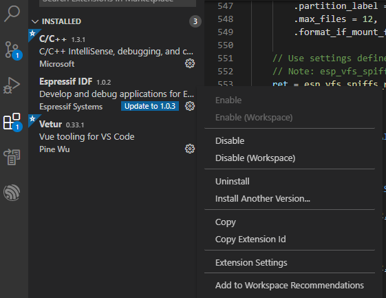

Currently I use the IDF terminal "idf.py flash monitor" when I make changes to the spiffs folders and use the compile/flash/monitor icon when only changing code.
Hope they fix the function soon, bit inconvenient doing 2 different processes and remembering I need to do it by command line if programming spiffs flash.
Right click at ESP IDF extension -> Install another version -> Choose 1.0.2 -> Reload VS Code -> Done.
Now, when the chip is flashed, the files will be uploaded.
"ESP IDF extension -> Install another version " is greyed out and cannot be selected.
At @ext:espressif.esp-idf-extension there is not an option to choose a different version.
I wish to roll back to 1.02; any suggestions would be most welcome. Thanks.
Re: Latest IDF extension for VSCode has broken my compiler
Posted: Fri May 14, 2021 10:08 am
by bunfight
I Uninstalled 1.03 then installed 1.02 from https://github.com/espressif/vscode-esp ... tag/v1.0.2. Project now builds and flashes OK.
ESP-IDF now highlights "update to 1.03" but "Install Another Version" is not greyed out and many previous versions can be selected whereas this option was unavailable when 1.03 was installed.
