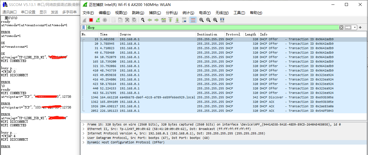

ESP32 DHCP 获取不到IP

I (698) : start tcp_client_task
I (708) WIFI: wait to get IP

netif: setting default interface st
dhcp_start(netif=0x3fca1d44) st1
dhcp_start(): restarting DHCP configuration
dhcp_start(): starting DHCP configuration
udp_bind(ipaddr = 0.0.0.0, port = 68)
udp_bind: bound to 0.0.0.0, port 68)
udp_connect: connected to 0.0.0.0, port 67)
dhcp_discover()
dhcp_discover(): dhcp state is DISCOVER
dhcp_select: could not allocate DHCP request
pbuf_alloc(length=308)
pbuf_alloc(length=308) == 0x3fc9d888
transaction id xid(7929a813)
dhcp_discover: making request
dhcp_discover: sendto(DISCOVER, IP_ADDR_BROADCAST, LWIP_IANA_PORT_DHCP_SERVER)

ethernet_input: dest:ff:ff:ff:ff:ff:ff, src:58:41:20:09:d9:62, type:800
pbuf_remove_header: old 0x3fc9daba new 0x3fc9dac8 (14)
ip_input: iphdr->dest 0xffffffff netif->ip_addr 0x0 (0x0, 0x0, 0xffffffff)
ip_input: iphdr->dest 0xffffffff netif->ip_addr 0x100007f (0xff, 0x7f, 0xffffff00)
ip4_input: packet accepted on interface lo
ip4_input:
IP header:
| 4 | 5 | 0x00 | 306 | (v, hl, tos, len)
| 0 |000| 0 | (id, flags, offset)
| 64 | 17 | 0xb912 | (ttl, proto, chksum)
| 192 | 168 | 0 | 1 | (src)
| 255 | 255 | 255 | 255 | (dest)
ip4_input: p->len 306 p->tot_len 306
pbuf_remove_header: old 0x3fc9dac8 new 0x3fc9dadc (20)
udp_input: received datagram of length 286
UDP header:
| 67 | 68 | (src port, dest port)
| 286 | 0xa866 | (len, chksum)
udp (255.255.255.255, 68) <-- (192.168.0.1, 67)
pcb (0.0.0.0, 68) <-- (0.0.0.0, 67)
udp_input: calculating checksum
pbuf_remove_header: old 0x3fc9dadc new 0x3fc9dae4 (8)
dhcp_recv(pbuf = 0x3fcb7c84) from DHCP server 192.168.0.1 port 67
pbuf->len = 278
pbuf->tot_len = 278
searching DHCP_OPTION_MESSAGE_TYPE
DHCP_OFFER received in DHCP_STATE_SELECTING state
dhcp_handle_offer(netif=0x3fca1d44) st1
dhcp_handle_offer(): server 0x0100a8c0
dhcp_handle_offer(): offer for 0x7a00a8c0
dhcp_select(netif=0x3fca1d44) st1
dhcp_select(): dhcp state is REQUESTING

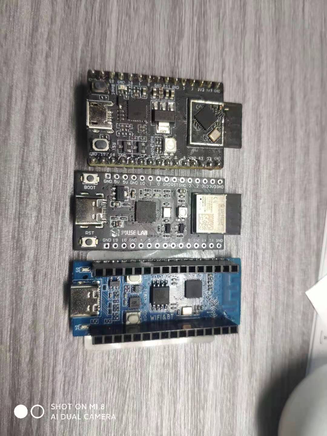

这里是获取到IP的,反复复位能获取到,换一个模块又会获取不到,两个模块都获取不到

I (688) Protocol: 0x3fcb7d3c fa 00 00 00 00 02 00 11 8c ff 05 00 |............|
I (708) : start tcp_client_recv_task
I (708) gpio: GPIO[4]| InputEn: 0| OutputEn: 1| OpenDrain: 0| Pullup: 0| Pulldown: 0| Intr:0
I (718) gpio: GPIO[5]| InputEn: 0| OutputEn: 1| OpenDrain: 0| Pullup: 0| Pulldown: 0| Intr:0
I (728) wifi:state: assoc -> run (10)
I (738) : start state_led_task
W (738) wifi:<ba-add>idx:0 (ifx:0, 58:41:20:09:d9:62), tid:5, ssn:0, winSize:64
I (748) : start get_RSSI_task
I (748) BLUFI_EXAMPLE: set rssi threshold
I (838) wifi:connected with TP-LINK_JSB_WZ, aid = 1, channel 1, 40U, bssid = 58:41:20:09:d9:62
I (838) wifi:security: WPA2-PSK, phy: bgn, rssi: -39
I (848) wifi:pm start, type: 1
I (848) wifi:set rx beacon pti, rx_bcn_pti: 14, bcn_timeout: 14, mt_pti: 25000, mt_time: 10000
I (858) wifi:BcnInt:102400, DTIM:1
dhcp_discover()
pbuf_add_header: old 0x3fc9d8d8 new 0x3fc9d8d0 (8)
udp_send: added header in given pbuf 0x3fc9d888
udp_send: sending datagram of length 316
udp_send: UDP packet length 316
udp_send: UDP checksum 0x4f58
udp_send: ip_output_if (,,,,0x11,)
pbuf_add_header: old 0x3fc9d8d0 new 0x3fc9d8bc (20)
ip4_output_if: st1
IP header:
| 4 | 5 | 0x00 | 336 | (v, hl, tos, len)
| 255 | 17 | 0xba9d | (ttl, proto, chksum)
| 0 | 0 | 0 | 0 | (src)
ip4_output_if: call netif->output()
pbuf_add_header: old 0x3fc9d8bc new 0x3fc9d8ae (14)
ethernet_output: sending packet 0x3fc9d888
dhcp_discover: deleting()ing
pbuf_free(0x3fc9d888)
pbuf_free: deallocating 0x3fc9d888
dhcp_discover: SELECTING
dhcp_discover(): set request timeout 500 msecs
I (998) BLUFI_EXAMPLE: WIFI_EVENT_STA_CONNECTED
I (1008) BLUFI_EXAMPLE: rssi:-38
I (1008) Protocol: 0x3fcb7c84 fa 00 00 00 00 02 00 11 8c e7 04 1f |............|
I (1018) BLUFI_EXAMPLE: mac:MAC6055f92888c4
dhcp_fine_tmr(): request timeout
dhcp_timeout()
dhcp_timeout(): restarting discovery
dhcp_discover()
pbuf_alloc(length=320)
pbuf_alloc(length=320) == 0x3fcb7c84
ip4_output_if: st1
IP header:
| 1 |000| 0 | (id, flags, offset)
| 255 | 17 | 0xba9c | (ttl, proto, chksum)
dhcp_discover(): set request timeout 1000 msecs
ip4_input:
IP header:
UDP header:
pbuf->len = 278
pbuf->tot_len = 278
pbuf_alloc(length=308) == 0x3fc9e0b8
pbuf_add_header: old 0x3fc9e108 new 0x3fc9e100 (8)
udp_send: added header in given pbuf 0x3fc9e0b8
udp_send: UDP checksum 0xdb0b
pbuf_add_header: old 0x3fc9e100 new 0x3fc9e0ec (20)
ip4_output_if: st1
IP header:
| 2 |000| 0 | (id, flags, offset)
| 255 | 17 | 0xba9b | (ttl, proto, chksum)
pbuf_add_header: old 0x3fc9e0ec new 0x3fc9e0de (14)
ethernet_output: sending packet 0x3fc9e0b8
pbuf_free(0x3fc9e0b8)
pbuf_free: deallocating 0x3fc9e0b8
dhcp_select: REQUESTING
dhcp_select(): set request timeout 2000 msecs
pbuf_free(0x3fcb7c84)
pbuf_free: deallocating 0x3fcb7c84
etharp_timer
dhcp_coarse_tmr()
pbuf_alloc(length=320) == 0x3fc9fc44
pbuf_remove_header: old 0x3fc9d932 new 0x3fc9d940 (14)
pbuf_alloc(length=320) == 0x3fcbc844
ip4_input:
IP header:
pbuf_remove_header: old 0x3fc9d940 new 0x3fc9d954 (20)
UDP header:
| 286 | 0xb174 | (len, chksum)
pbuf_alloc(length=60)
pbuf_alloc(length=60) == 0x3fcbc874
pbuf_alloc(length=305)
pbuf_alloc(length=305) == 0x3fcbc8a4
pbuf_alloc(length=60) == 0x3fcbc8d4
pbuf_alloc(length=60) == 0x3fcbc688
pbuf_alloc(length=60) == 0x3fcbc6b8
pbuf_remove_header: old 0x3fc9d954 new 0x3fc9d95c (8)
dhcp_recv(pbuf = 0x3fc9fc44) from DHCP server 192.168.0.1 port 67
pbuf->len = 278
pbuf->tot_len = 278
pbuf_free(0x3fc9fc44)
pbuf_free: deallocating 0x3fc9fc44
pbuf_remove_header: old 0x3fc9dfda new 0x3fc9dfe8 (14)
ip4_input:
IP header:
pbuf_remove_header: old 0x3fc9dfe8 new 0x3fc9dffc (20)
UDP header:
| 286 | 0x9d66 | (len, chksum)
pbuf_remove_header: old 0x3fc9dffc new 0x3fc9e004 (8)
dhcp_recv(pbuf = 0x3fcbc844) from DHCP server 192.168.0.1 port 67
pbuf->len = 278
pbuf->tot_len = 278
DHCP_ACK received
dhcp_check(netif=0x3fca1d44) st
dhcp_check(): dhcp state is CHECKING
etharp_find_entry: found empty entry 0
etharp_find_entry: selecting empty entry 0
etharp_request: sending ARP request.
pbuf_alloc(length=28)
pbuf_alloc(length=28) == 0x3fcbc6e8
etharp_raw: sending raw ARP packet.
pbuf_add_header: old 0x3fcbc710 new 0x3fcbc702 (14)
ethernet_output: sending packet 0x3fcbc6e8
pbuf_free(0x3fcbc6e8)
pbuf_free: deallocating 0x3fcbc6e8
dhcp_check(): set request timeout 500 msecs
pbuf_free(0x3fcbc844)
pbuf_free: deallocating 0x3fcbc844
ethernet_input: dest:ff:ff:ff:ff:ff:ff, src:58:41:20:09:d9:62, type:806
pbuf_remove_header: old 0x3fcbe9f2 new 0x3fcbea00 (14)
etharp_update_arp_entry: 192.168.0.1 - 58:41:20:09:d9:62
etharp_find_entry: found empty entry 1
etharp_find_entry: no empty entry found and not allowed to recycle
etharp_input: incoming ARP request
etharp_input: we are unconfigured, ARP request ignored.
pbuf_free(0x3fcbc874)
pbuf_free: deallocating 0x3fcbc874
ethernet_input: dest:ff:ff:ff:ff:ff:ff, src:9c:b6:d0:c1:1a:87, type:800
pbuf_remove_header: old 0x3fcbf09a new 0x3fcbf0a8 (14)
ip_input: iphdr->dest 0xff00a8c0 netif->ip_addr 0x0 (0x0, 0x0, 0xff00a8c0)
ip_input: iphdr->dest 0xff00a8c0 netif->ip_addr 0x100007f (0xc0, 0x7f, 0xff00a800)
ip4_input: UDP packet to DHCP client port 54915
ip4_input: packet not for us.
pbuf_free(0x3fcbc8a4)
pbuf_free: deallocating 0x3fcbc8a4
pbuf_remove_header: old 0x3fcbf742 new 0x3fcbf750 (14)
pbuf_free(0x3fcbc8d4)
pbuf_free: deallocating 0x3fcbc8d4
pbuf_remove_header: old 0x3fcc078a new 0x3fcc0798 (14)
pbuf_free(0x3fcbc688)
pbuf_free: deallocating 0x3fcbc688
dhcp_timeout()
dhcp_timeout(): CHECKING, ARP request timed out
etharp_find_entry: found matching entry 0

#define IP_DEBUG LWIP_DBG_ONRe: ESP32 DHCP 获取不到IP
看起 LWIP 模块没有收到底层上来的包,不确定是不是共存导致 WIFI RX 没收到路由器的 DHCP offer。你如果把蓝牙关了,能不能获取到 IP。

下载了ESP32-C3-MINI-1-V2.3.0.0的固件,也是获取不到IP看起 LWIP 模块没有收到底层上来的包,不确定是不是共存导致 WIFI RX 没收到路由器的 DHCP offer。你如果把蓝牙关了,能不能获取到 IP。
使用 IDF wifi station 示例(examples/wifi/getting_started/station)也拿不到 IP?是只有这个路由器拿不到 IP 还是都拿不到 IP?换个模组能否拿到 IP?

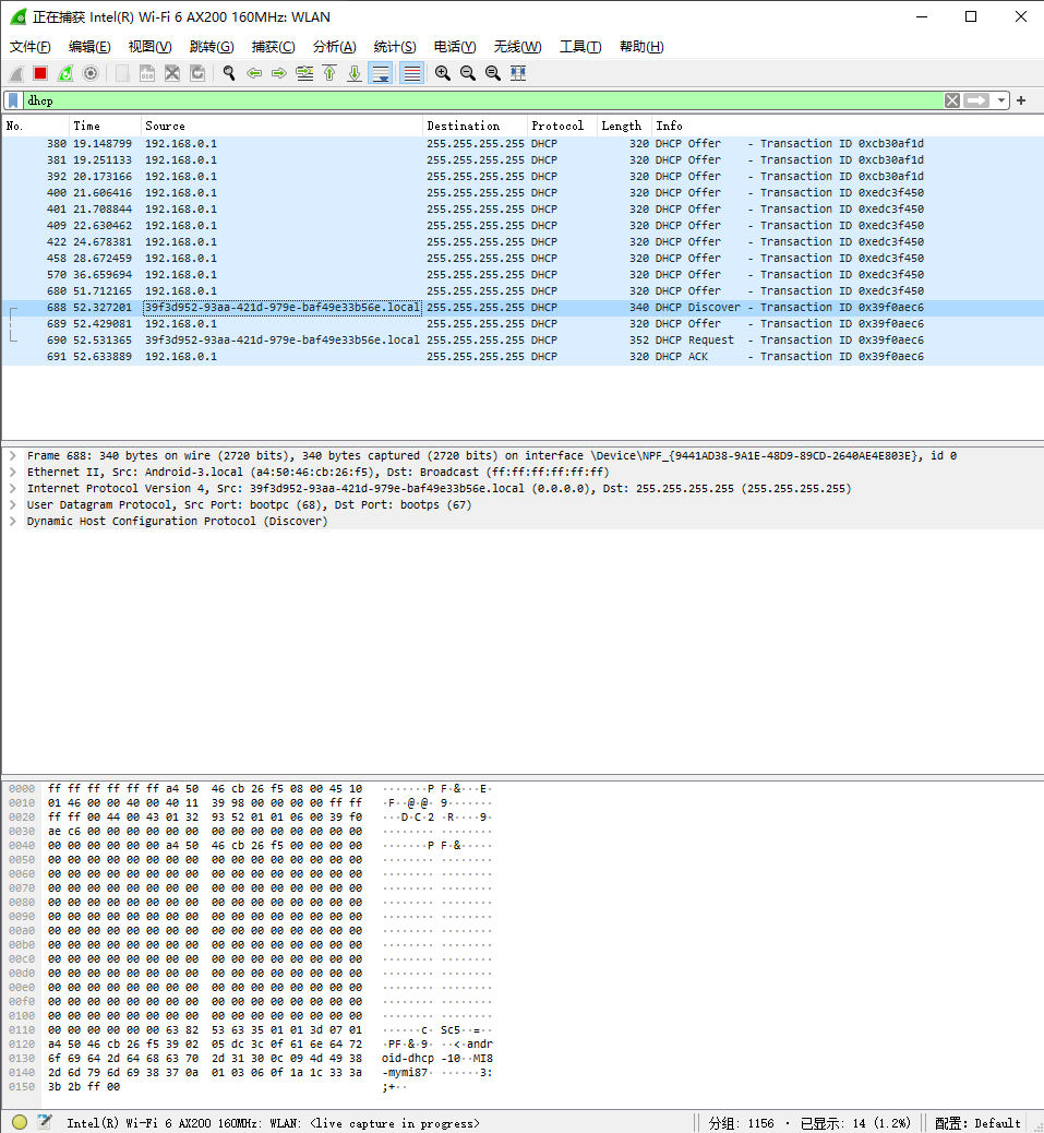

尝试了这3个模块,下载了examples/wifi/getting_started/station例程都不能获取到IP。 还有比较奇怪的是,能抓到手机的discover和request,抓不到模块的使用 IDF wifi station 示例(examples/wifi/getting_started/station)也拿不到 IP?是只有这个路由器拿不到 IP 还是都拿不到 IP?换个模组能否拿到 IP?
只要esp32c3连这个路由器都很难获取到IP,手机电脑都有很多连这个wifi正常使用。使用 IDF wifi station 示例(examples/wifi/getting_started/station)也拿不到 IP?是只有这个路由器拿不到 IP 还是都拿不到 IP?换个模组能否拿到 IP?
esp32c3连接其他wifi都能获取到IP。
