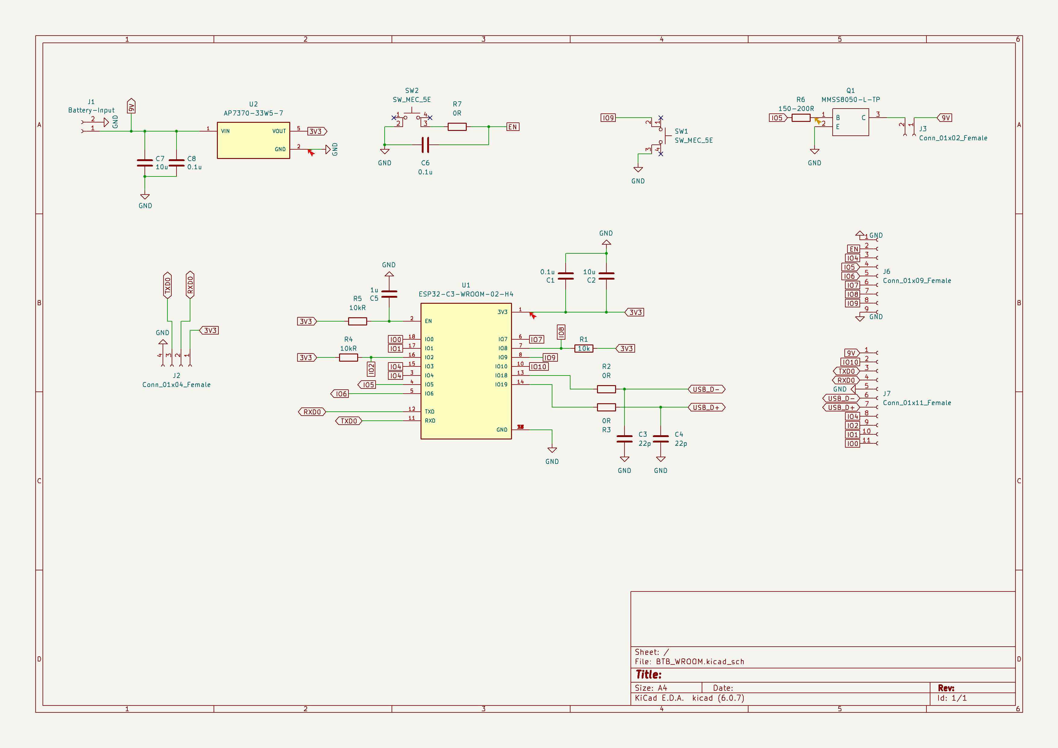

I re-designed my circuit to use the WROOM-02 module and to be more flexible in regards of debugging.
I have not changed the power circuit for the 3.3V, but I changed the LDO that I want to use. Beside from that I added more points for debugging purpose.
Is there anything I need to change so that the other module can run smoothly? I have followed the design guidelines and the peripheral schmematics in the datasheet. In addition I have used button switches to switch "IO9" and "EN" from HIGH to LOW to enable flashing.
I am thankful about any feedback on this circuit.

Re: ESP32-C3-MINI-1 Flash via UART
That LDO still can only source 300mA. You need something that can do 500mA at least. The classic jellybean LDO for that would be an LM1117-3.3, but if you need lower dropout or quiescent current, you may want to look a bit further.
