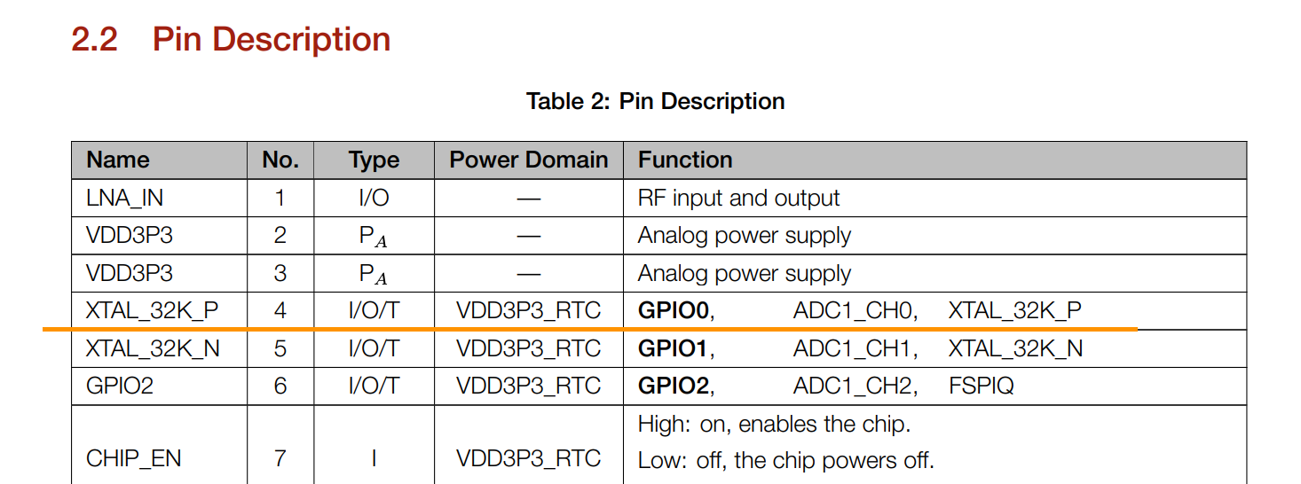

I have this PCB custom made that uses ESP32C3 FN4. Initially I had lot of problems like not using the ESP variant with in built flash and using some another crystal instead of 40MHz and I wasn't able to upload any sketches to my custom PCB.
After long long long awaiting, I finally managed to get my hands on proper components and replace them. This custom board is really really tiny. Just 20mmX40mm. While designing this board. I knew I will have to include atleast one LED so I can know if my code is working. I placed it on ESP32C3-FN4 physical pin4.
I'm programming this board using Arduino IDE and I know that Arduino IDE maps the GPIOs with different labels than actually the physical pins of the IC. This is because Arduino IDE refers them with a context of some development board.
So now, I'm bit confused as how my pins are mapped or how Arduino IDE considers them.

Should I write digitalWrite(SCK, HIGH); to turn ON the LED or like how it should be? I'm not asking about what logic I need to pass. What I'm trying to know is, On my custom PCB LED is connected to physcial4 pin of my ESP32-C3 FN4 IC. So to toggle/Access that pin what should be the pin Number in my Arduino code for command...let's say digitalWrite( ,HIGH);

You need to check the chip datasheet, in this case https://www.espressif.com/sites/default ... eet_en.pdf. In chapter 2.2, there is a pinout diagram. For example, for pin 4 of the package, you will find that it corresponds to GPIO0. Therefore you need to pass "0" as the GPIO number in Arduino.
Screenshot 2023-07-25 at 11.34.38.png (144.53 KiB) Viewed 4929 times

by Crazy electron
Thanks I'll check and get back to tell you how it goes.
