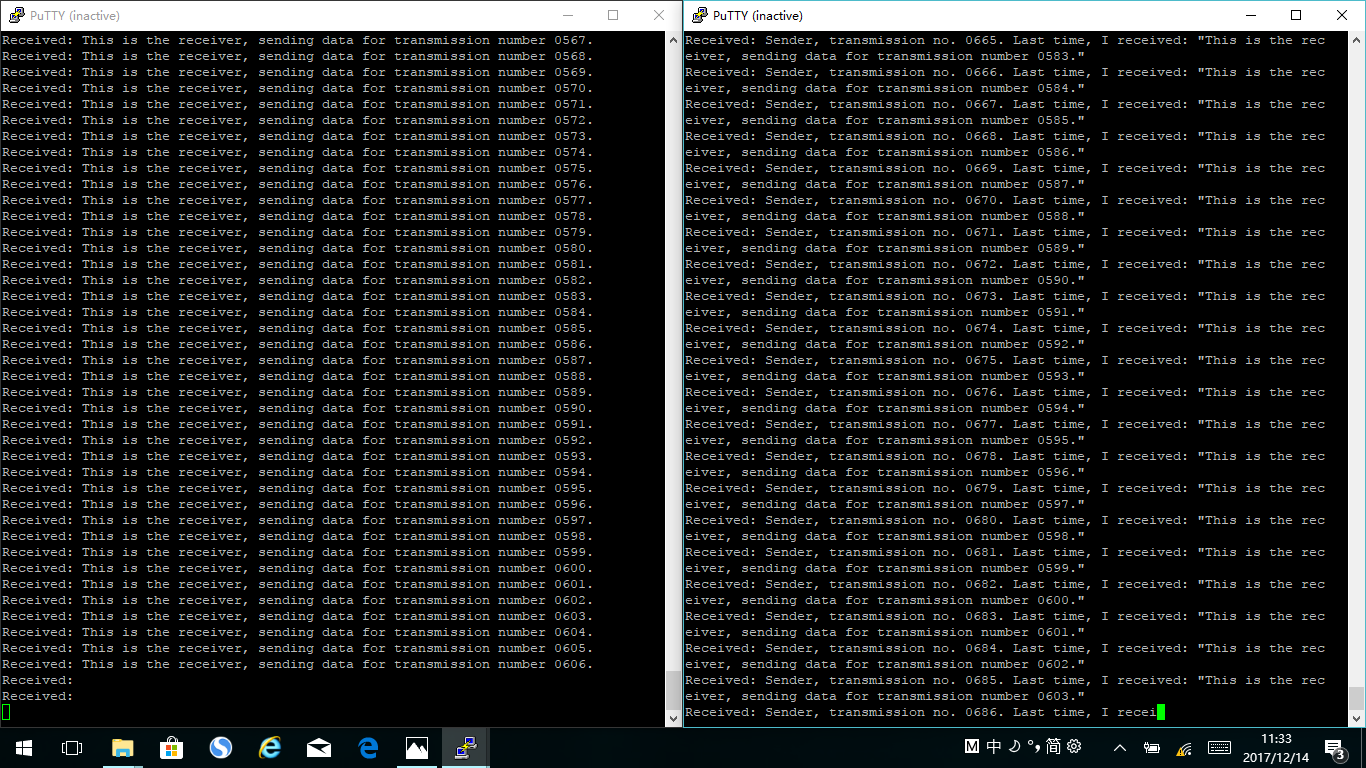

Hi! ESP_Sprite,
Thanks for your reply.
I used the spi-slave sample upon two esp32-kit.
When I raise the sender's speed(ex. .clock_speed_hz=10000000), I receive messy message.
When I reduce the speed to 8MHz(.clock_speed_hz=8000000), it work well.
What's wrong with the spi-slave? Thank you!

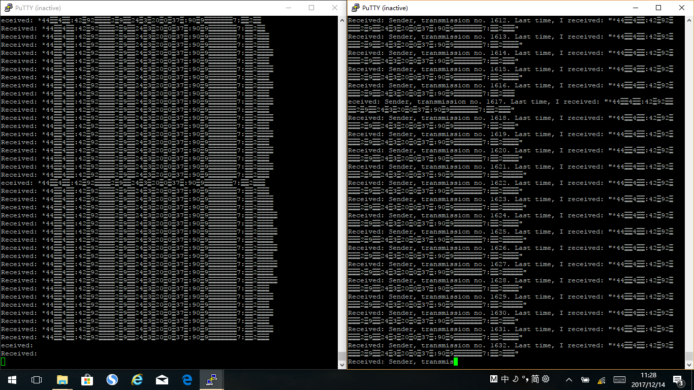

Hello!ESP_Sprite,
When I set .clock_speed_hz=8000000, the spi work well.
spi-slave 8M
But, when I set .clock_speed_hz=10000000, I receive wrong data as follow.
spi-slave 10M
Thanks!
Posts: 10617
Re: SPI slave mode (example)
Postby Sprite » Thu Dec 14, 2017 9:04 am
Any chance you can connect an oscilloscope to your signal lines? I'm thinking that stray capacitance or something may mess up your clock signal.
