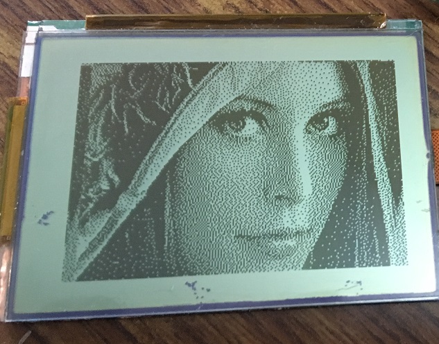

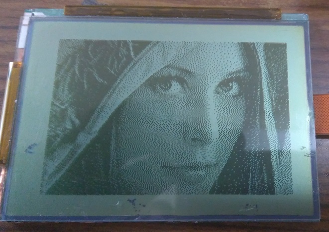

ESP_Sprite, you were right about the weird ordering, I noticed this only with a bitmap image. Had to swap odd and even bytes in the source image buffer before extracting the 4bit data for each packet.
But i still have a problem with the line synchronization, left and right borders are swapped. Still hopeful.

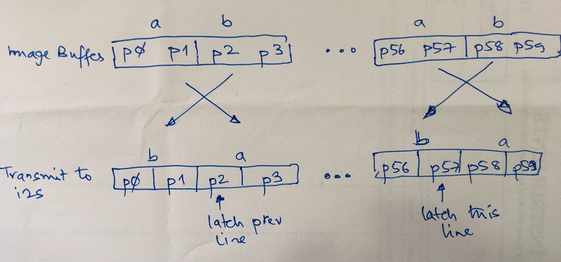

Maybe something you overlooked: It's not the pixels that are swapped, it's the actual bytes getting loaded into the I2S path. So instead of just swapping the pixels around, you should swap around the way you write into the I2S buffer. If you don't, the sync signals will still be written 'straight' and me emitted in the wrong place.
Nice image, by the way. Wondering if you can do grayscale by sending an image at 240fps and doing tdm...
doh, you're right of course. I did try to fix it, and got an improvement. Right edge is clean, but am still not getting the whole line. Have tried latching previous line on first pixel, or current line on last pixel. First option looks better - shows more of the right side, left border is smaller.
With the original PIC24 graphic controller, the HS latch pulse is on the last pixel of the row, but it's a short pulse (< 1/2 clock period, and positive edge is when clock is low). As per the info I have, the line data is latched on the falling edge of the HS pulse.
With this setup, the HS pulse is one full clock period with positive edge synced to clock positive edge. I tried inverting the HS pulse with 'gpio_matrix_out()', but the lcd doesn't like that, no image at all.
But maybe there is something else I haven't taken care of.
I would be interested to see the source to create data including sync signals.
In the code below that generates this image, I am basically hacking the FR toggle by placing two copies of the same image in a buffer with FR = 0 for the first and FR= 1 for the second, the i2s just loops around both. I suppose this could be done via an interrupt setting a gpio rather than through the i2s parallel bus.

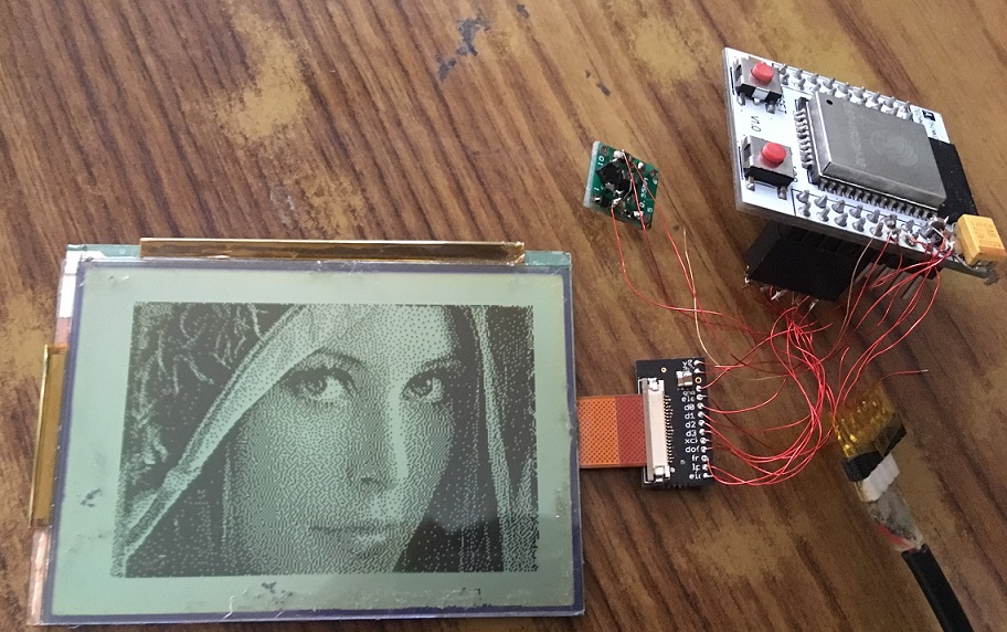

And this is my simplified i2s_parallel.c for 8bit lcd mode ...

Hacked a solution ! I eventually figured that the data packets during which the HS pulse was high were ignored by the LCD, since the HS pulse was a full clock period in width. I ended up padding each row at the end with 4 extra packets (32 bits) with HS high, and it works !
BTW, I had another problem with my previous solution, the VS pulse also needs to be delayed a few clocks into the first row and continue for a few clocks into the second row. That became obvious with another test bitmap with a rectangle 1-pixel border 240x160.
And I have decided to go for a hw solution to generate FR : edge triggered D latch to convert each VS pulse into a level toggle. 74LVC1G80 is tiny (SOT23), and just $0.06, can stick that on the breakout board for the lcd connector. So the i2s bus just needs to be 6bits (4 bits data + HS + VS). Once I have working code for a back-buffer, with the D-latch hardware, I will publish the solution on github.
ESP_Sprite, many thanks again for your help.

As promised, esp-idf project published on github at https://github.com/har-in-air/ESP32-LCD-I2S
I used a modified version of Chuck Lohr's 3d graphics code to demonstrate the application.
