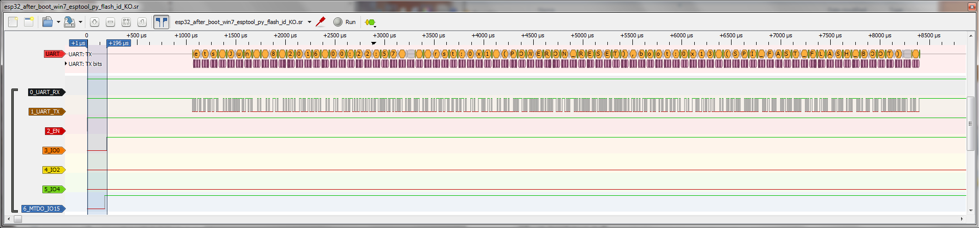

I have done some Sigrok (PulseView) capture of the signals (tested with Windows7)
esp32_after_boot_win7_esptool_py_flash_id_KO:
This screenshot corresponds to automatic boot by esptool.py (with parameter flash_id) which fail
Root cause SPI Boot mode (IO0 high) instead of UART0 Download mode(IO0 low)
For more details you can download Sigrok file here:
http://hydrabus.com/esp32_boot/esp32_af ... h_id_KO.sr
Corresponds to UART decoded data (extracted from sigrok capture):
sigrok-cli -i ../esp32_after_boot_win7_esptool_py_flash_id_KO.sr -P uart:rx=0_UART_RX:tx=1_UART_TX:baudrate=115200:format=hex -A uart=tx-data -O hex:width=128 > ../esp32_after_boot_win7_esptool_py_flash_id_KO.txt

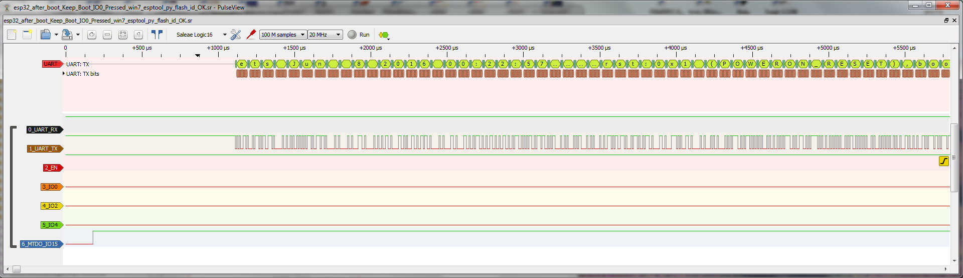

esp32_after_boot_Keep_Boot_IO0_Pressed_win7_esptool_py_flash_id_OK:
This screenshot corresponds to forced UART0 Download mode(IO0 low) button Boot always pressed and use of esptool.py (with parameter flash_id) which work fine
http://hydrabus.com/esp32_boot/esp32_af ... h_id_OK.sr
sigrok-cli -i ../esp32_after_boot_Keep_Boot_IO0_Pressed_win7_esptool_py_flash_id_OK.sr -P uart:rx=0_UART_RX:tx=1_UART_TX:baudrate=115200:format=hex -A uart=tx-data -O hex:width=128 > ../esp32_after_boot_Keep_Boot_IO0_Pressed_win7_esptool_py_flash_id_OK.txt
Result (of sigrok-cli Ascii Hex converted to binary):

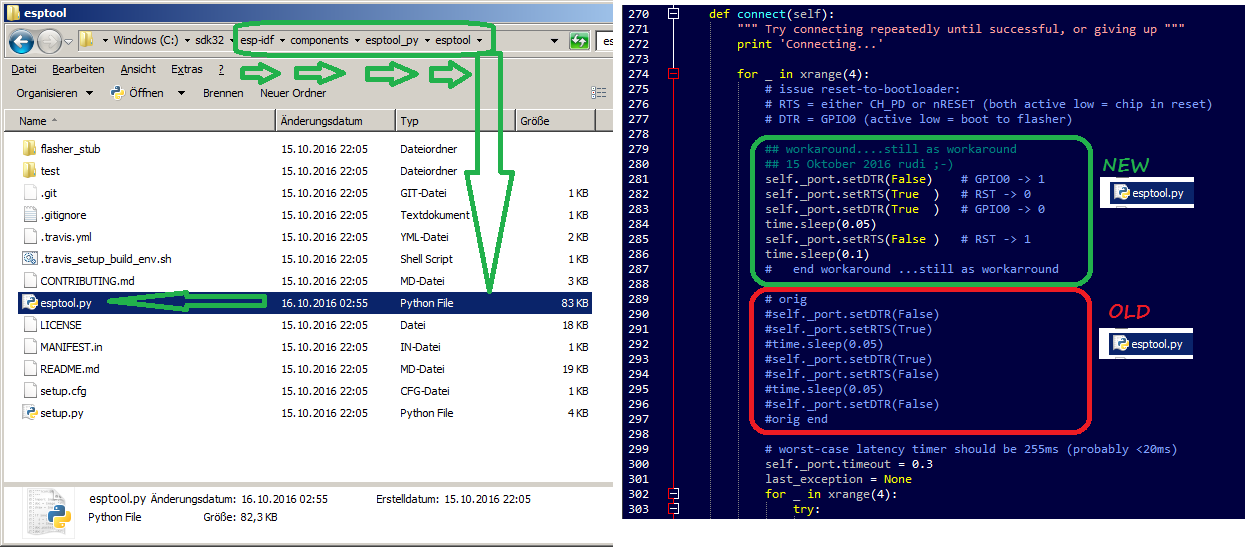

I also confirm that by modifying esptool.py
from
            self._port.setDTR(False)
            self._port.setRTS(True)
            time.sleep(0.05)
            self._port.setDTR(True)
            self._port.setRTS(False)
            time.sleep(0.05)
to
            self._port.setDTR(False)    # GPIO0 -> 1
            self._port.setRTS(True  )   # RST -> 0
            self._port.setDTR(True  )   # GPIO0 -> 0
            time.sleep(0.05)
            self._port.setRTS(False )   # RST -> 1
            time.sleep(0.1)
That fix the problem on win7 (thanks to rudi post http://esp32.com/viewtopic.php?f=13&p=1512#p1512)

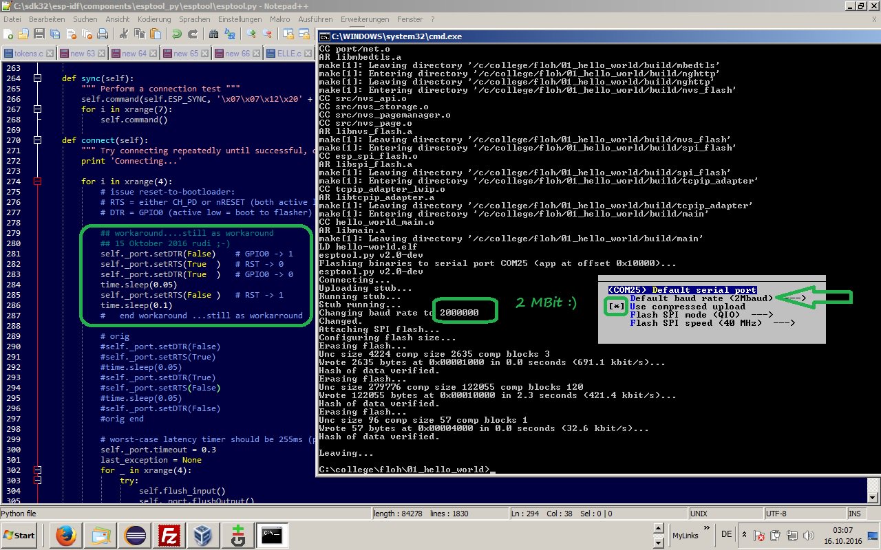

Postby rudi ;-) » Tue Oct 18, 2016 9:53 pm
https://github.com/themadinventor/espto ... ol.py#L278
change the lines
            time.sleep(0.05)
            time.sleep(0.05)
to this
## workaround....still as workaround
## 15 Oktober 2016 rudi ;-)
            time.sleep(0.05)
            time.sleep(0.1)
#   end workaround ...still as workarround
and you go on with auto flash in
-> Developer V2
-> Nano32
you find the esptool.py here
