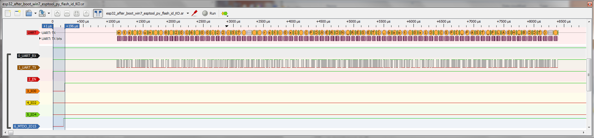

I have done some Sigrok (PulseView) capture of the signals (tested with Windows7)
esp32_after_boot_win7_esptool_py_flash_id_KO:
This screenshot corresponds to automatic boot by esptool.py (with parameter flash_id) which fail
Root cause SPI Boot mode (IO0 high) instead of UART0 Download mode(IO0 low)
For more details you can download Sigrok file here:
http://hydrabus.com/esp32_boot/esp32_af ... h_id_KO.sr
Corresponds to UART decoded data (extracted from sigrok capture):
sigrok-cli -i ../esp32_after_boot_win7_esptool_py_flash_id_KO.sr -P uart:rx=0_UART_RX:tx=1_UART_TX:baudrate=115200:format=hex -A uart=tx-data -O hex:width=128 > ../esp32_after_boot_win7_esptool_py_flash_id_KO.txt
Result (of sigrok-cli Ascii Hex converted to binary):
ets Jun  8 2016 00:22:57
configsip: 0, SPIWP:0x00
mode:DIO, clock div:2
load:0x3ffc0000,len:0
load:0x3ffc0000,len:3028
ho 0 tail 12 room 4
load:0x40078000,len:4092
load:0x40098000,len:704
entry 0x400981dc
and so on

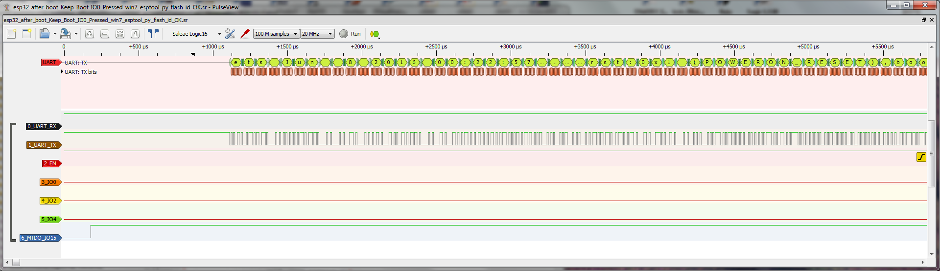

esp32_after_boot_Keep_Boot_IO0_Pressed_win7_esptool_py_flash_id_OK:
This screenshot corresponds to forced UART0 Download mode(IO0 low) button Boot always pressed and use of esptool.py (with parameter flash_id) which work fine
http://hydrabus.com/esp32_boot/esp32_af ... h_id_OK.sr
sigrok-cli -i ../esp32_after_boot_Keep_Boot_IO0_Pressed_win7_esptool_py_flash_id_OK.sr -P uart:rx=0_UART_RX:tx=1_UART_TX:baudrate=115200:format=hex -A uart=tx-data -O hex:width=128 > ../esp32_after_boot_Keep_Boot_IO0_Pressed_win7_esptool_py_flash_id_OK.txt
rst:0x1 (POWERON_RESET),boot:0x3 (DOWNLOAD_BOOT(UART0/UART1/SDIO_REI_REO_V2))
waiting for download
