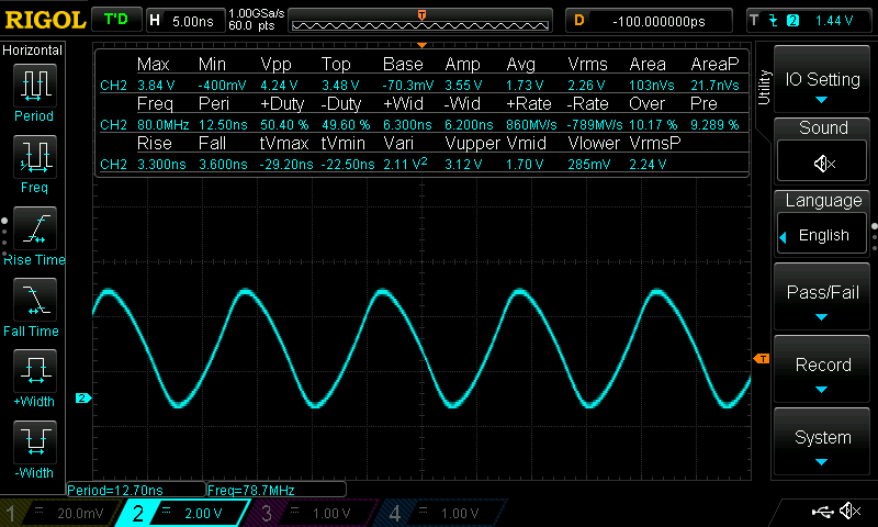

Do you happen to have a scope which can display 80/160/320 MHz signal? Or a frequency meter? We can pull out these clocks to a pad and check whether PLL is working or not.

by igrr
Ok, i think it will still be good enough to show presence/absence of clock signal.
Could you please add the following at the start of esp_clk_init function ($IDF_PATH/components/esp32/clk.c):
    const int sig_num = 8;
    PIN_FUNC_SELECT(PERIPHS_IO_MUX_GPIO0_U, FUNC_GPIO0_CLK_OUT1);
    REG_WRITE(PIN_CTRL, sig_num);
And then the second test with sig_num = 13.
Value 8 should route the 80MHz clock divided from the PLL, to GPIO0. Value 13 should route 80 or 160MHz clock, depending on the selected CPU frequency.
The result i expect is that when you see that the chip locks up, no clock will be observed on GPIO0 (both in the case of sig_num=8 and sig_num=13). If this is the case, we will proceed to troubleshoot PLL configuration. If this is not the case, we will need to think what else can cause the lock-up.

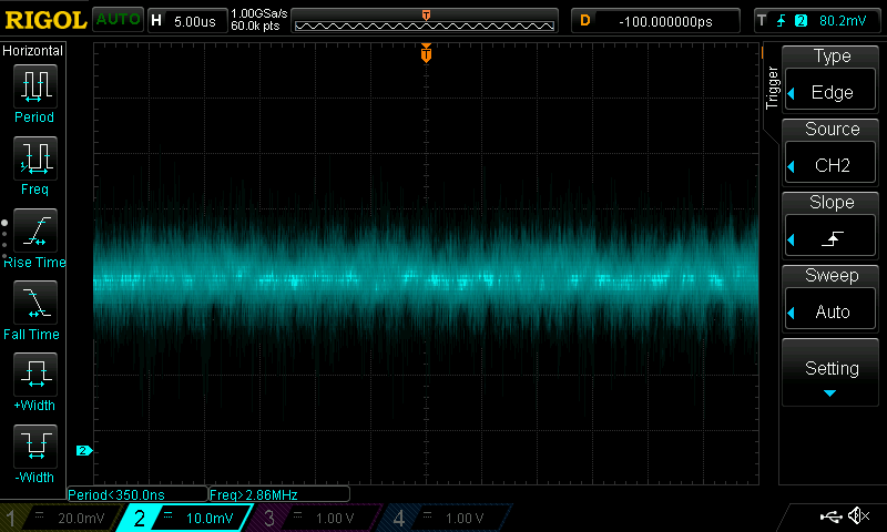

With sig_num = 8 and freq set at 80MHz, I only got noise on GPIO0. Both in functional and non-functional state.
Noice

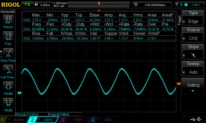

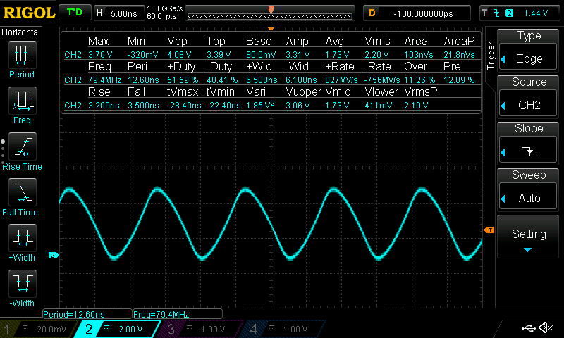

However, with sig_num = 13, I got this at 80MHz. The device is in a working state (blinking a LED on GPIO5)
Working, sig_num=13, 80MHz
When hung, it looks pretty much the same, though the duty cycle is then exactly 50/50 compared to the previous image where it actually differs over time by up to 2%.
Hung, sig_num=13, 80MHz
Results for 160MHz in the next post (can only add three images it seems)

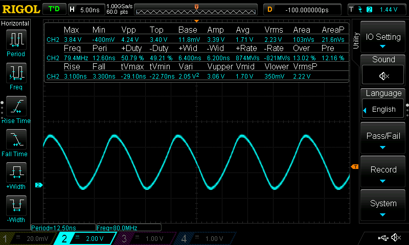

Posted: Wed Oct 25, 2017 6:53 pm
by permal
Increasing freq to 160MHz gives the following result. Still a 80MHz signal(I double checked the freq setting to make sure it is at 160MHz)
sig_num=13, 160MHz, functional
And for completeness, here is sample where it is hung with freq set at 160MHz. Again, 80MHz signal.
sig_num=13, 160MHz, hung
